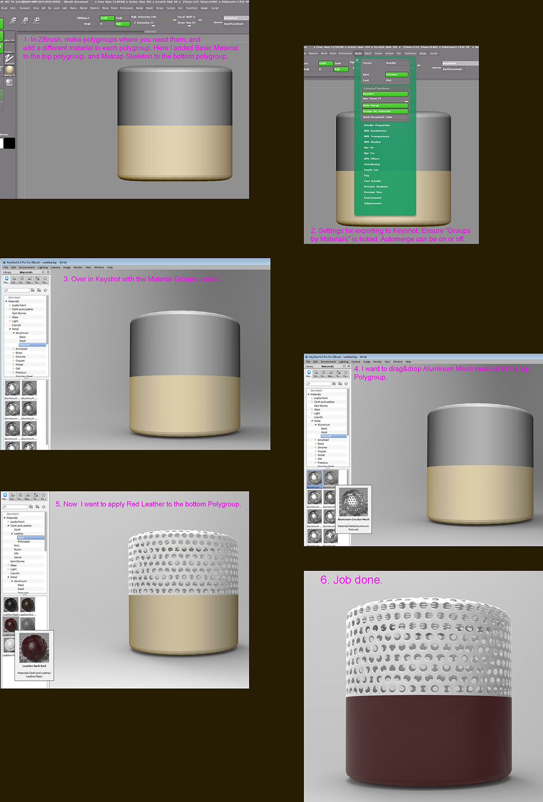

Anyway, I forgot to tell you to ensure in ZBrush Render settings to untick Auto-Merge, and Tick Groups By Materials. This will allow you to drag and drop materials to groups in Keyshot.
Also I just realized in an earlier post I said to apply different colours to the polygroups. I should have said to apply different MATERIALS, not colours. Very sorry for any confusion.
Here is a screengrab of the process.
I hope that helps. You can still add colours to the polygroups for better visibility if you want to, but it’s the Materials you really need to apply so Keyshot can recognize your groups.
