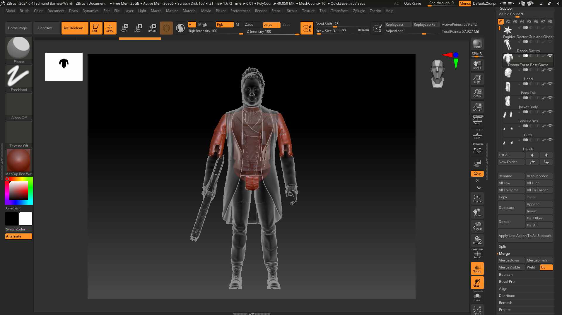

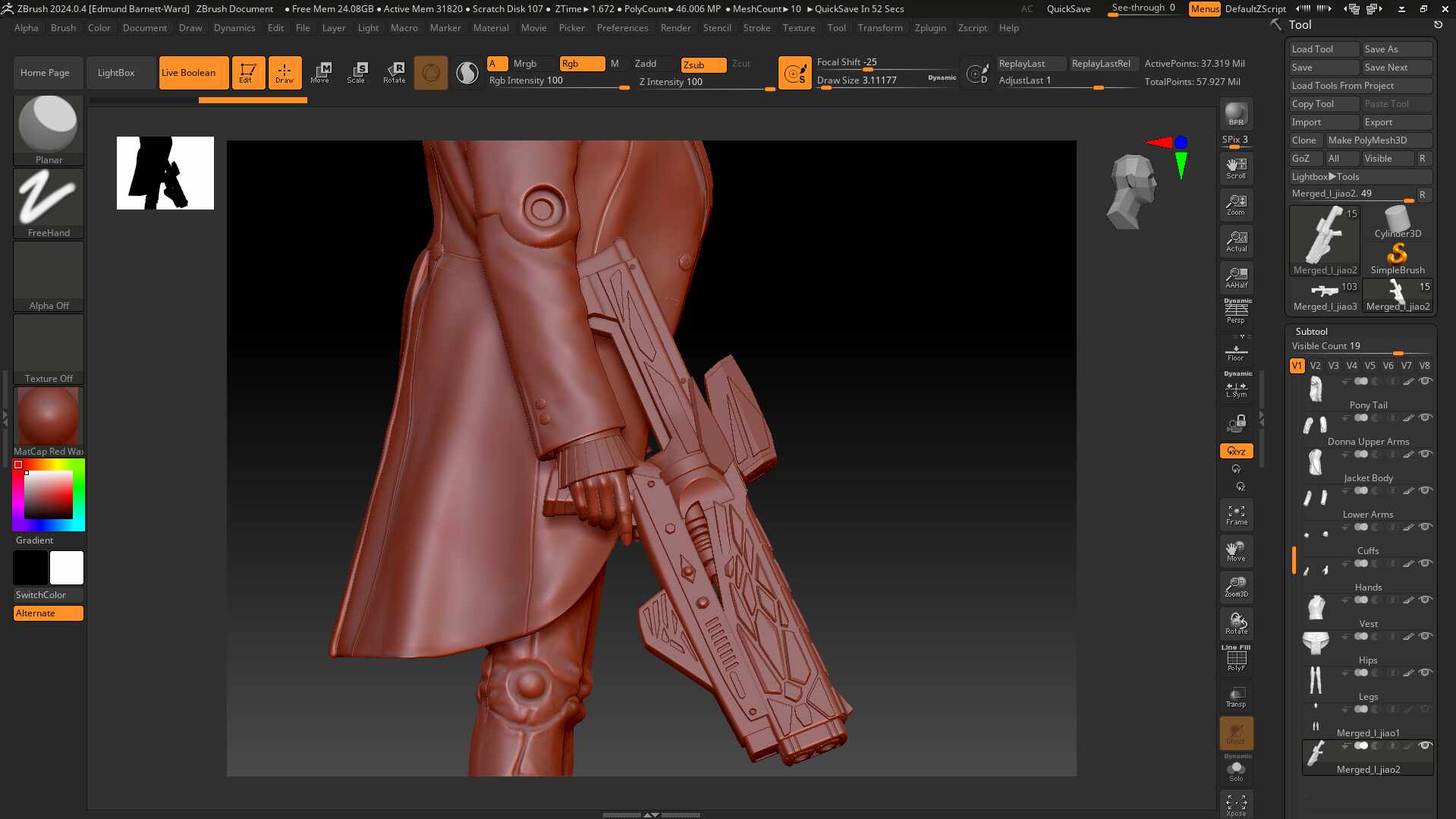

The Fugitive Doctor is one of the rare incarnations of the Doctor who feels comfortable using weapons. I really love ZModeler and Boolean for their combined ability to throw shapes together and quickly arrive at some very complex designs. When I design a gun, I break it down into its components and organize them into folders. These folders are then combined into an assembly folder. If I need to make changes, I can easily modify the specific part and slot it back into the final assembly.
Usually, I sculpt everything in ZBrush. Whenever possible, I prefer to sculpt my characters starting from their anatomy so that the clothing looks more natural. However, sometimes I have to base my sculpts on an existing figure. For example, the Fugitive Doctor was based on the 10th Doctor’s companion Donna. I reused the torso core, upper arms, hips, thighs, and knees from that figure which I was given as scan data that had been taken at the factory. This meant I had to create the character’s unique look while using another character’s anatomy as a base!

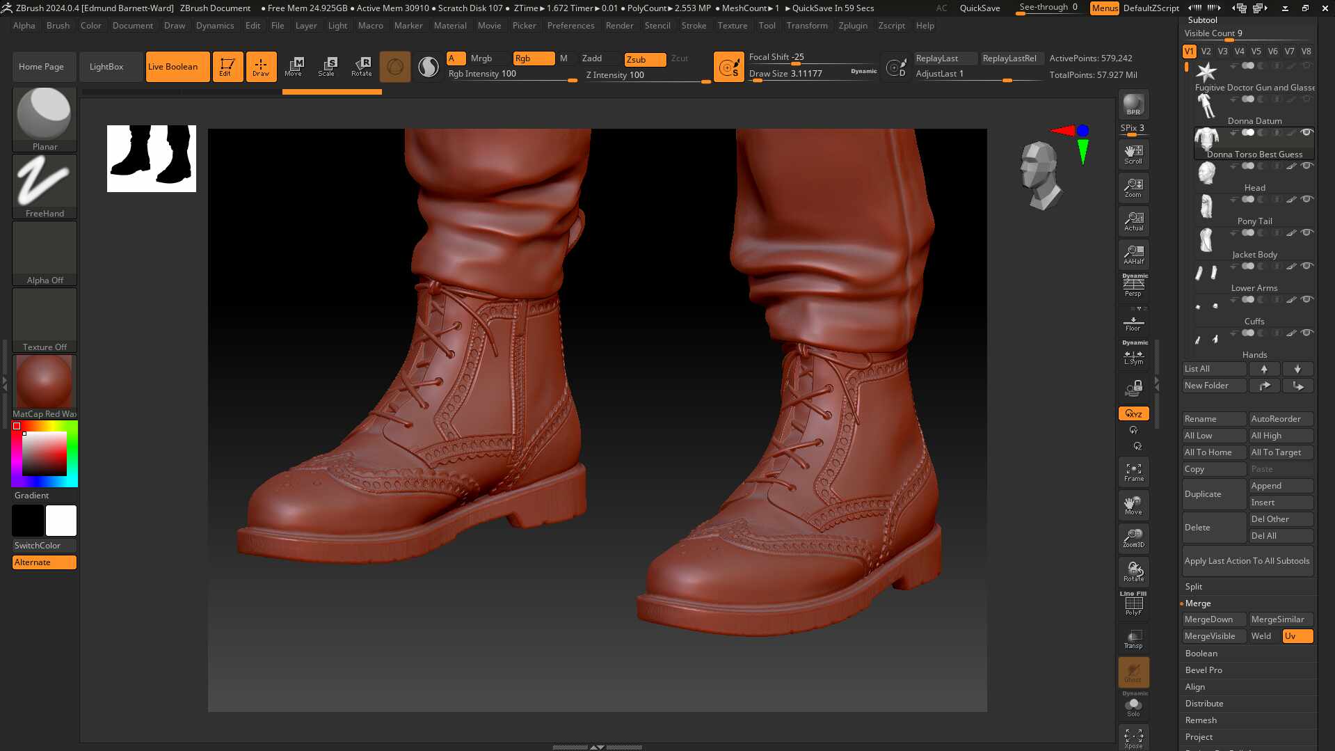

I sculpt shoes in layers. First, I create a base shape for the entire shoe or boot. Using the extract tool, I add pieces of ‘leather’ to build up realistic layers. I use the ‘CurveTubeSnap’ brush for the laces. For the brogue holes, I create an ‘InsertMesh’ brush with a cylinder, switch the stroke to ‘freehand’, activate ‘LazyMouse’, and adjust the ‘LazyStep’ to space the holes correctly. I set the depth in the brush palette to “0” and draw cylinders where the holes will be. Then, I split the cylinders into a separate subtool and use them with Boolean to create the final result. This method ensures that I can change the boot’s shape without worrying about preserving the details, as they are added last.

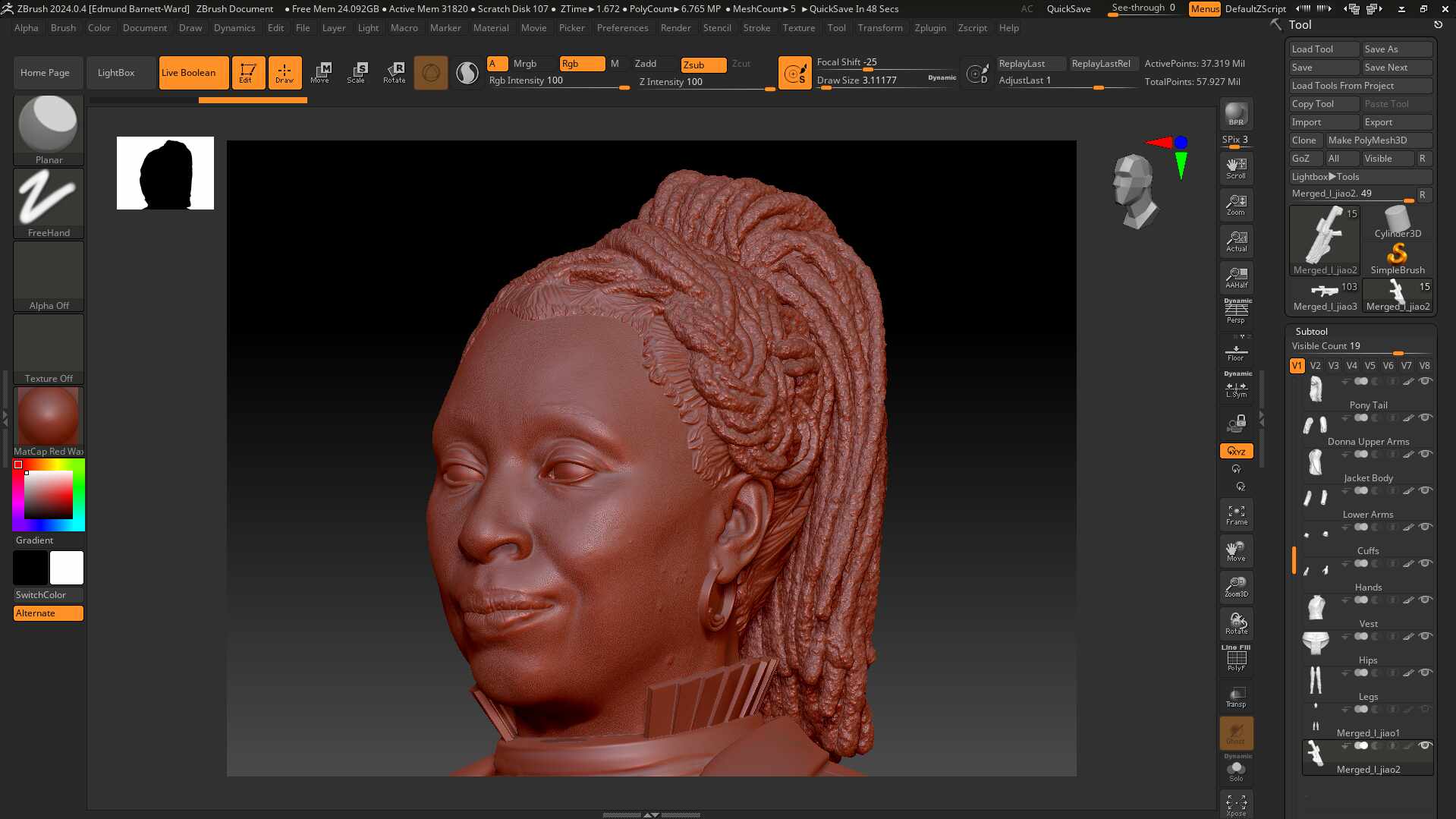

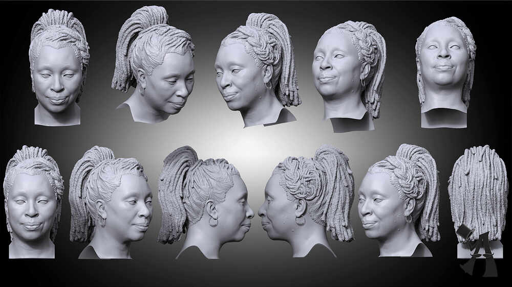

Jo’s beautiful dreadlocks were sculpted using the ‘CurveTubeSnap’ and ‘CurveTube’ brushes with a custom noise from the ‘Surface’ palette. The roots of the dreads were sculpted using ‘ClayBuildup’ with a diffused circular alpha and the roll distance set to “2” in the Stroke>Modifiers Palette. Changing the roll distance elongates the stroke, creating a nice taper at the end with a crisp ‘hair strand’ effect.
