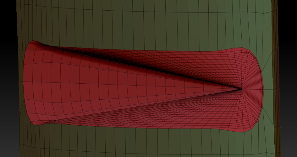

In the following image I’ve framed a section of the mesh using Stroke->Curve Functions->Frame Mesh.
Using the Topology Brush I should be able to hold ALT and drag across the ends to clear the loop from those areas, leaving me with two distinct, straight curves which I can apply an insert mesh to. But when I do that, this happens:
I’m stumped. I tried various tweaks, but always got the same result. Odds are its a really obvious thing that I’m missing, but if anyone could help it would be greatly appreciated. Thanks ahead of time.
