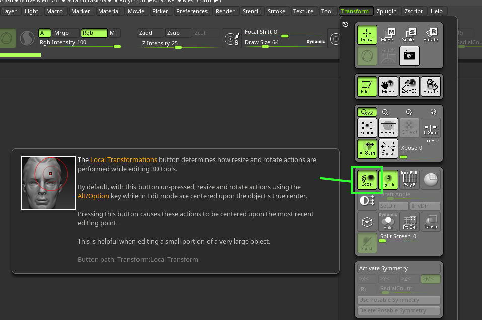

Hi @Kalina029 Welcome to ZBrush Central
Make sure that Local Transformations is enabled.
2021-03-06 12_20_36-Greenshot
Ahhh, I tried messing around with that menu but missed that button. Thank you!
You’re welcome! I’m glad that solved it for you. Cheers!
