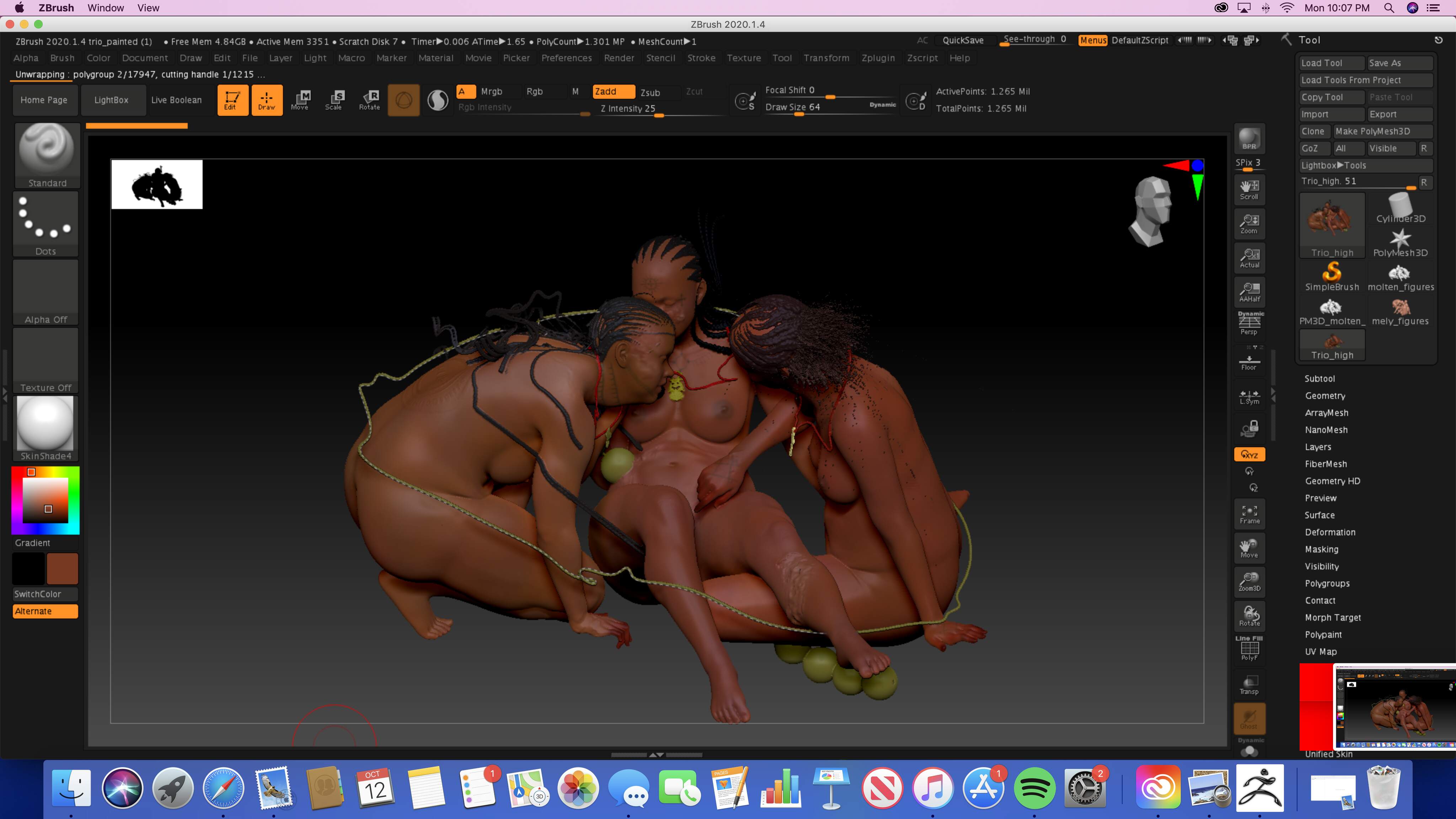

I am having a reaccuring issue with trying to unwrap my UVS for my model. I have tried with symmetry on and not selected to see if it would possibly make it work, but it has failed regardless in either attempt. As the screenshot shows below, it will start calculating but ultimately fail each time. I have tried using Zremesher to transfer the details over to a lower-poly count, but lost too many details in doing so…is there any way to fix this, I really need to be able to export this UV map to get it back into MAYA to finish off…any suggestions would be appreciate.

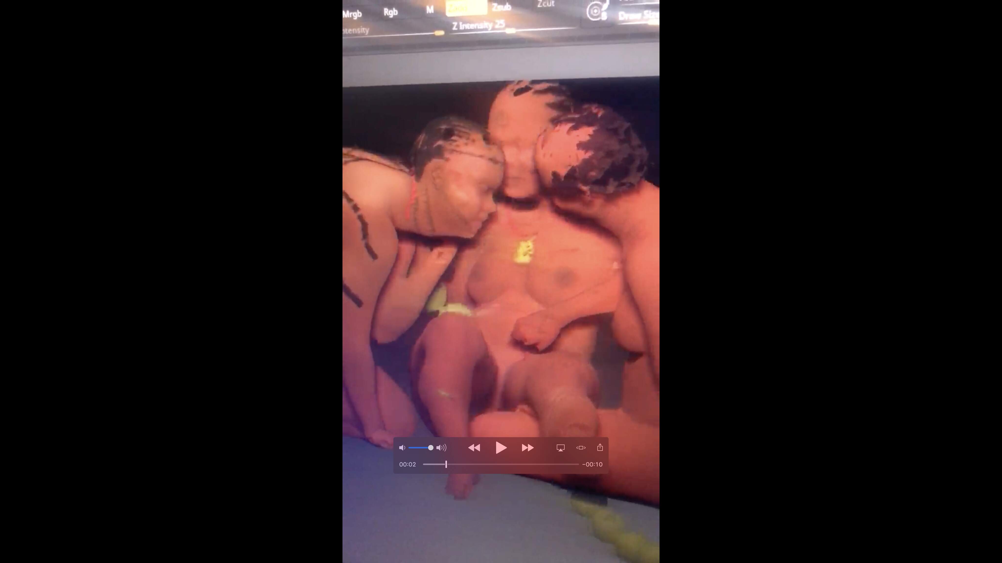

I have followed these instructions, but have still lost large amounts of detail on the hair and legs/fingers of the animations, is there any way you can inspect the file? I am not sure if it has something to do with the structure at this point Screen Shot 2020-10-19 at 11.47.06 AM
