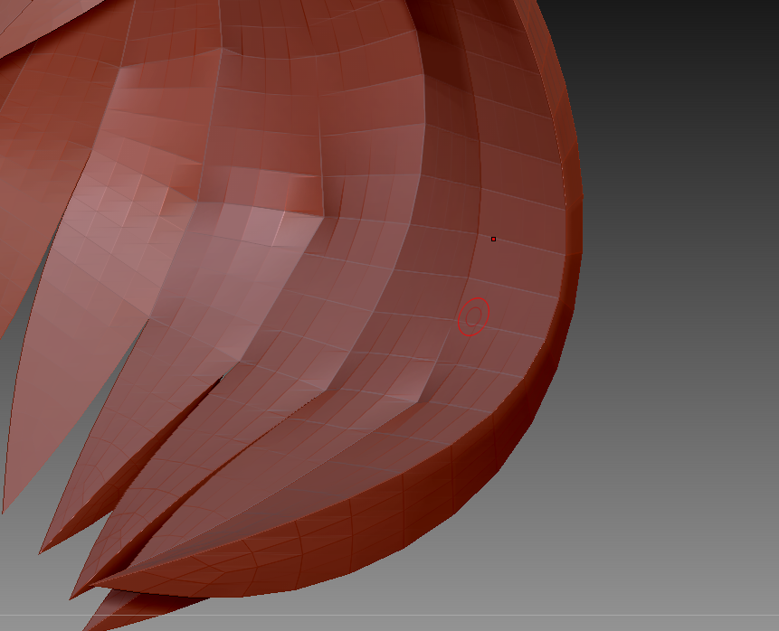

Is this normal crease behavior?

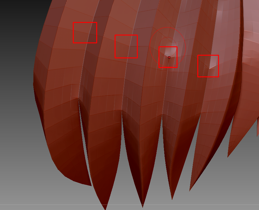

Why do some look pinched and others look fine? I have checked the geometry and there’s nothing extra.
Back:
Can it be that the geometry has zero thickness in these areas? It looks like front and back faces are overlapping. When you touch these areas with a brush, the mesh behaves strange sometimes…
Kind regards,
Selwy
Yes, there’s zero thickness in those areas. But why the difference though? All areas I marked have 0 thickness. The ones that look fine stay looking fine when I use a brush on them.
Care to show your actual creasing?
I get what happened now. Some edges were getting double creased because they are shared between clumps of hair. I just had to switch to single edge creasing on Zmodeler.
