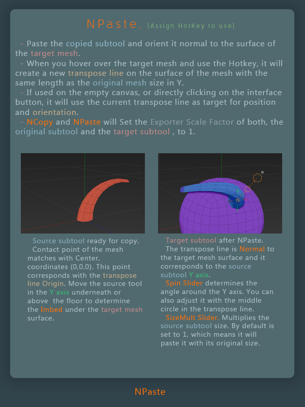

I also made a little plugin and creatively named it NPaste… you will be able to paste with the original size and orient it to the normal of the target mesh similar to what InsertMesh does. I didn’t really have the time to test it much so it might have bugs…
Download Thread
