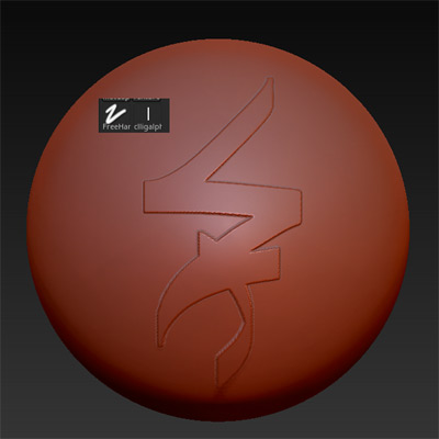

In the Brush pallet , under Alpha and texture, there is the Align To Path slider.
You can set this from 0 to 25.  This slider changes the rate at which the brush alpha will orientate itself to the direction of the stroke.   I want to totally turn off any alignment of the brush alpha to the stroke, and even with the slider set to 25 ( the least amount of orientation to the path)  the brush alpha still aligns it self to the stroke pretty quickly.  I want to draw on a surface with a rectangular alpha and  get a calligraphy  line type look, where the line goes from thick to thin.  So I need to stop the alignment to path completely. Any way to do that?
