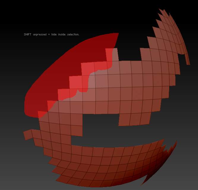

I’m not familiar with Wings but for the benefit of others trying to do this (and in case you haven’t tried this method):
Selecting individual polys is pretty easy in ZBrush using the lasso. Obviously you need to be zoomed in close. The method I use is:
  1. Switch on Polyframe (Shift + F) so you can see the polys. Hide all but the general area you want to work on using Shift+Ctrl+lasso.
  2. Scale the model so you can work on individual polys.
  3. Remove the polys you don’t want by Shift+Ctrl+lasso+release Shift (the area turns red). This will hide the poly you selected. Note that you only need to select a single point to hide the whole poly.
  4. Press Tool>Polygroups>Group Visible.
[attach=205213]Hidden_polys.jpg[/attach]
Notes:
  • Grouping Visible early on can help if you are working on something complex. You can then easily reselect the area you were working on.
  • The options in the Tool>Visibility submenu can be very useful - Grow, Shrink and Outer Ring.
  • Switch on Tool>Display Properties>Double so that your mesh doesn’t disappear when rotating (and you don’t miss polys that have their backface towards you).
HTH,
