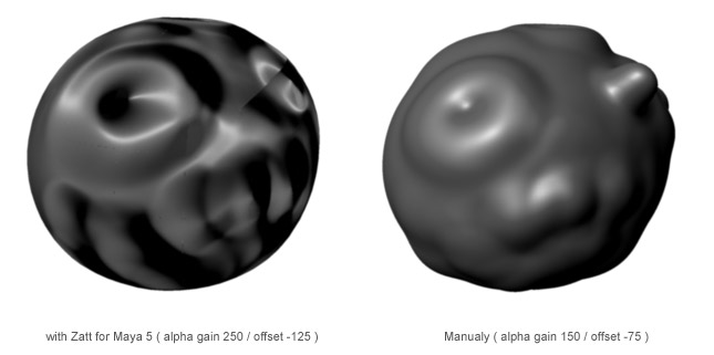

Hmm, weird nobody else notices this but the script does not create displacements but some kind of bumpmap. I’m only know the basics about maya and I can’t figure out what the shader does exactly, but it sure doesn’t look like displacements to me. Look at the silhouette of you object, it’s as smooth as a baby’s bottom :slight_smile:
you need to adjust your alpha gain to use this properly.
maybe I’m stupid but even when I set the alpha gain to a silly amounts I get no displacements at all. Just very high bumps.
You can also see this in the sword images Glickerish posted. On first sight you might think it’s displecament, but when you look closely its clearly just a bumpmap.
I atached an image to illustrate the difference between displacements and the result I get with the Zatt script more clearly.
email me the file and the displacement image to

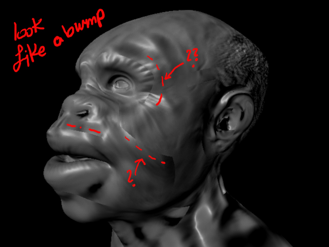

the mel works fine regarding hte approximation
but i guess its missing something , or I am
cause here is the result i got with the head from this thread
Rendering ZBrush Displacement-Maps In External Renderers
it looked like a bump map
yes, i got the same result as ashaiad vbmenu_register(“postmenu_179215”, true); .:qu:
thanks to Miguel Ortega
here is my work flow
first get the image from zbrush , open it in photoshop , then image auto contrast
open maya
get the obj file , run the script choose the image
disable the bump map
and it should be fine

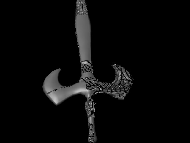

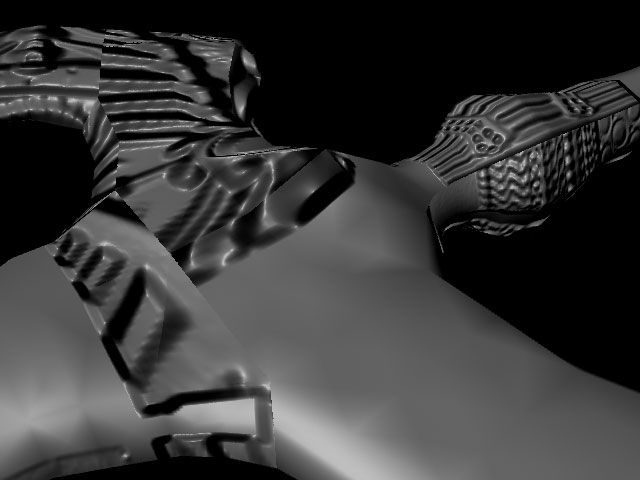

Hello.
I’ve download the script and i’m able to run it in maya 6.0.
I download the sword obj and displacement tif from zbrush’s site.
I bring the tif into Photoshop, auto contrast, run zatt6, render with mr and get the results you see in the attached images. ?
any ideas from anyone why?
tia!
Looks like your displacement map is flipped vertically.
