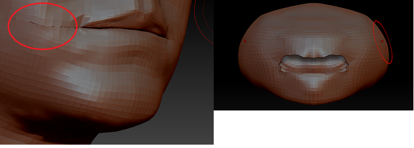

Thanks for your advice I did it by polygrouping the lower jaw and lip to the rest, now i did a hole and create the mouth-bag but I have another question, how can I sculpt the mouthbag ? Indeed, I can’t sculpt it because it is hidden behind the skin and so I can’t not clearly see my modification when I draw and even less draw on it without affecting the skin ? Should I polygroup the mouthbag ? And Is it better to have teeth and tongue in another subtool ?

Sorry , I am a bit noob with polygroup, I understand it is useful to isolate part of mesh but how can I deal with the gap created between the polygroups ? I can’t sculpt anymore between the polygroups without increase this gap

Have you polygrouped the mesh portions, or have you actually split them into a separate subtool?
Mesh portions that you need to be able to sculpt on simultaneously in unbroken fashion should be part of the same subtool, and separated by polygroups. Polygroups should not separate as I’m seeing in the picture. Although, if you sculpt across the border of a polygroup while one of them is hidden or masked, it can result in a seam or a crease in that location.
Subtools are completely separate meshes, and cannot be sculpted on at the same time as geometry in another subtool.
So in this case, you’d ideally want your face to be one polygroup, and the mouth cavity to be another polygroup that ends at the inner lips. In this way you can quickly hide the exterior face to work on the mouth cavity. If you happen to sculpt across the border while the other polygroup is hidden, it will be in an out of sight location where you can touch up any seams.
They are in the same subtool in the picture, just other part are hidden with ctrl shift, currently i have just 4 subtool: Face, eyes, teeth and body. Here I have five polygroup : ears, eyes area, mouth cavity, the lower jaw with the lower lips, and the rest of the face
