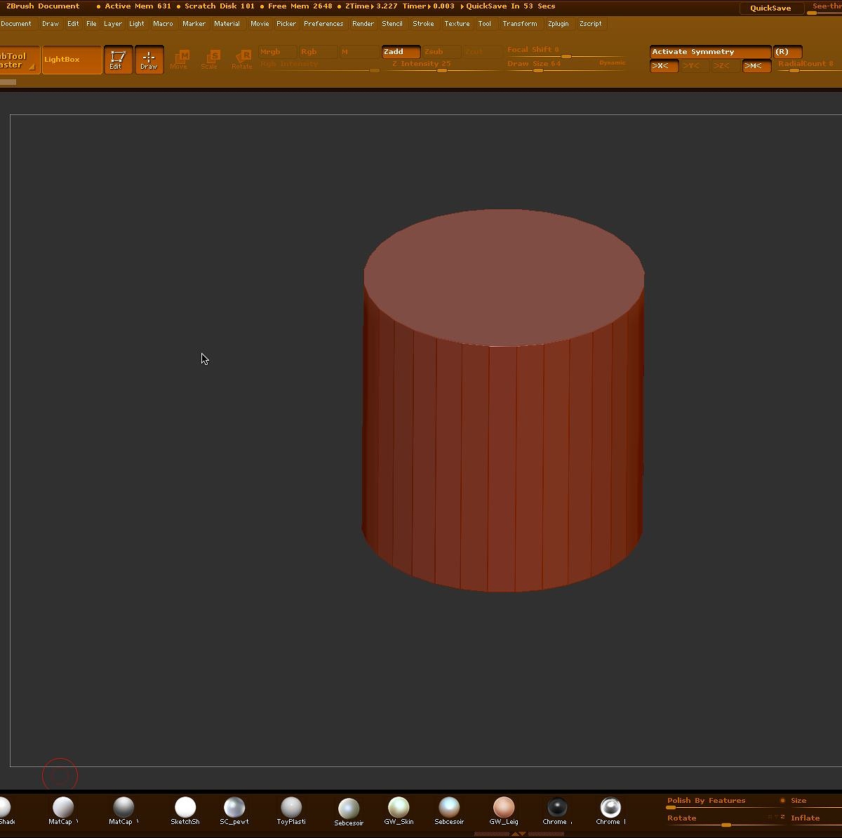

Just a tip for those that have wondered how to add the Turn on Symmetry and options x,y,z and Radial ® and Radial Count to the top of your interface.
Before starting just in case so you don’t lose your interface options all ready set go to Preferences Menu and Save Ui somewhere on your computer. Just to back it up. Also you can use this with your Custom Interface as long as you have enough room up top. You can also place these options below too instead if you choose.

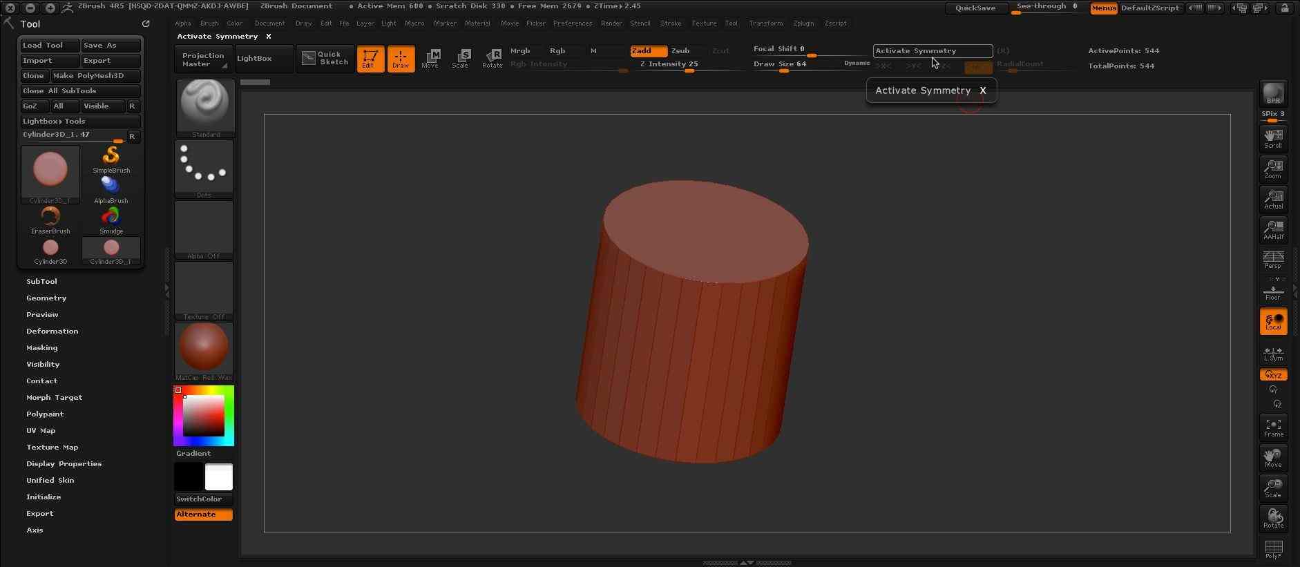

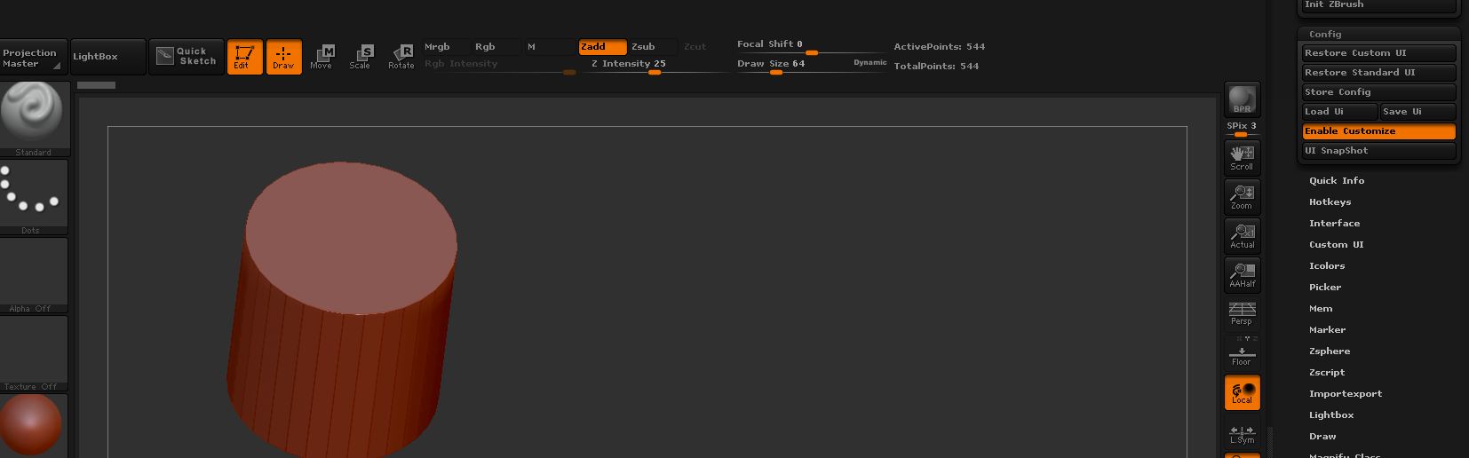

Go to the Preferences Menu/Config and turn on Enable Customize Button.
Select a 3d Primitive like the Cylinder and draw it on the Canvas and turn on the Edit Button.

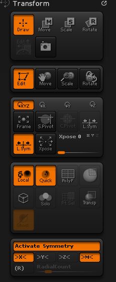

Now if you go to your Transform Menu you will see that the Activate Symmetry and all of it’s Options can now be used where as if the Cylinder3D or other Primitive was not in Edit mode it wouldn’t be active.

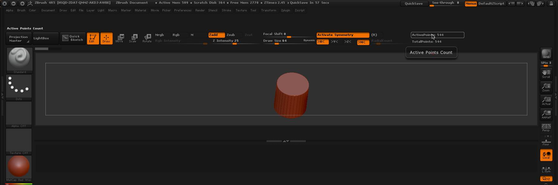

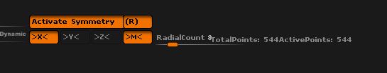

Now grab each button and the Sliders one at a time over to the top of your interface

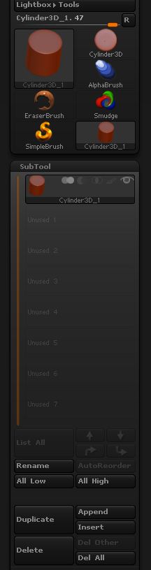

Once you have all of your buttons lined up on the interface turn off Edit, Clear the Layer, go to your Cylinder3d (or the 3D Primitive you chose to use and go to the Tool/SubTool menu and hit Delete button and then hit Ok.

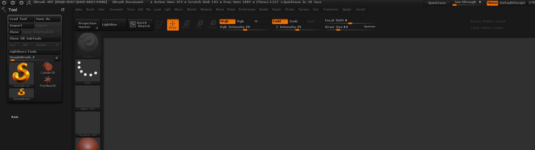

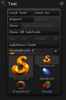

Hit the Simple Brush in the Tool Menu and then hit the R (Reset) Button. This is so that it shows only the usual start up buttons.
Turn off the Enable Customize Button
Hit the Save Ui Button and save it to your computer don’t use the same name as your back up Custom Interface or it will write over the last save
Hit Store Config Button and Hit OK

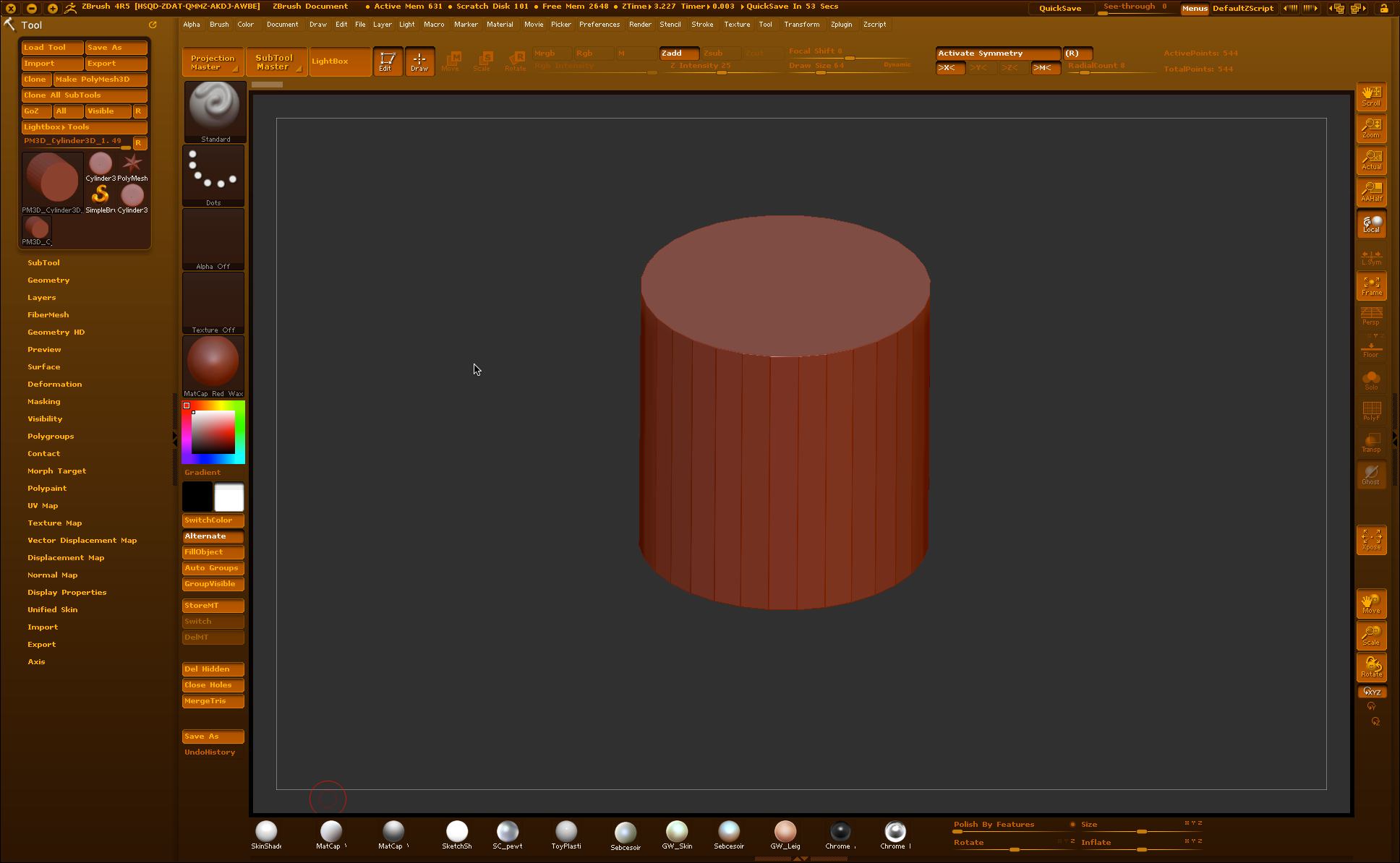

Close ZB and open it back up. It will seem like the buttons didn’t work. To make sure they did select a Primitive again go into edit mode and they should pop up on the interface where you put the buttons.
