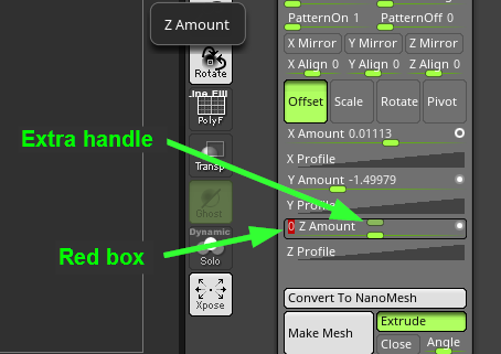

If you double click on a slider, you will get an extra handle which is used for fine adjustments. Grab that handle to adjust. The number box will also turn red at which point you can enter numerical values for really fine adjustments.
Note: not all sliders have the fine adjustment handle function but all sliders do have the red number box.

@Zber2 Thanks man! I knew about the extra handle but I did not know that a double click would activate it. I used to drag to the range I wanted and then tap it again to try and get the extra handle. For whatever reason that had only a 50:50 success rate for me. However the double click is much more reliable. Awesome.
