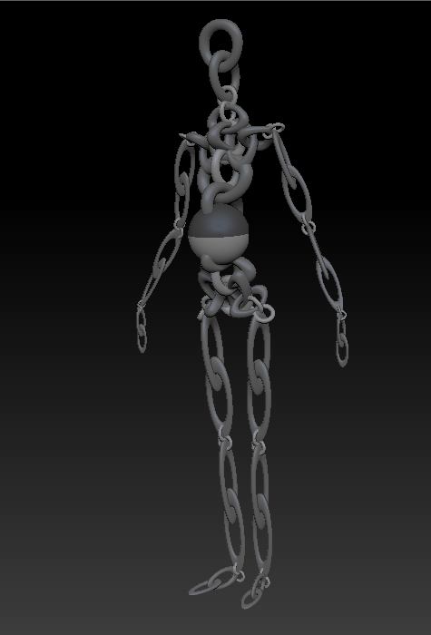

I think i will try to create complex manequin as a tool for future action figure sculpting. Do you think would be possible to insert jointing systems replacing the Zspheres? I never tryed it but i think it´d a be an interesting point to start with this kind of pre-articulated manequins :idea:
I’m not really sure. I suppose the connector meshes could be bones with sockets at the ends and then the zspheres themselves could be balls. But there’d be no way to restrict the movement, so you couldn’t simulate actual joints. Also it’s quite difficult to get the inserted meshes to maintain their proportions (though I suppose they’d be OK if made to fit).
It will be interesting to see what you come up with!
Yep totally agree. It will not be functionally working action figure with joints for every purpose, but i think it would be a great start point as skeleton with all the joints already placed. So after modelling and refining your figure you will have your joints placed and ready for boolean operations. Would be an opposite workflow as it is now: Modeling the entire figure and then split and add joints. I believe this is also a traditional aproach, using pre-made skeletons with funtional joints. Will give it a try and will post some results.
