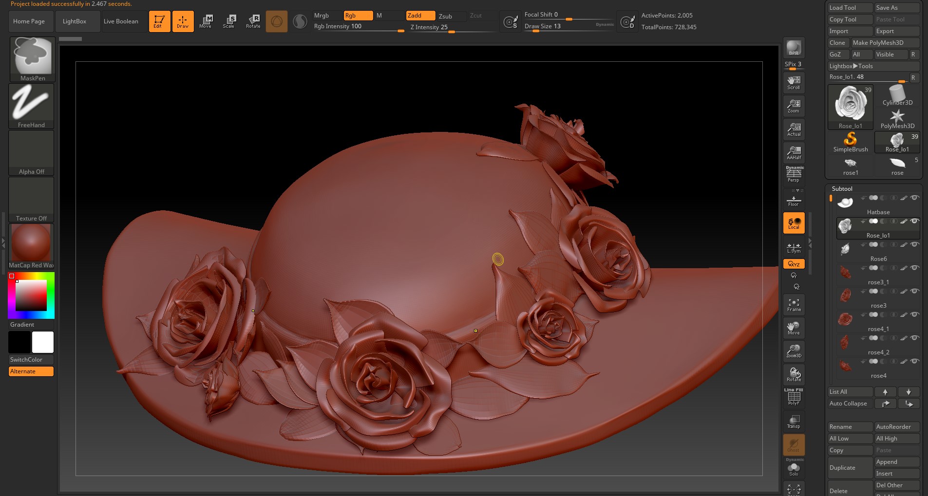

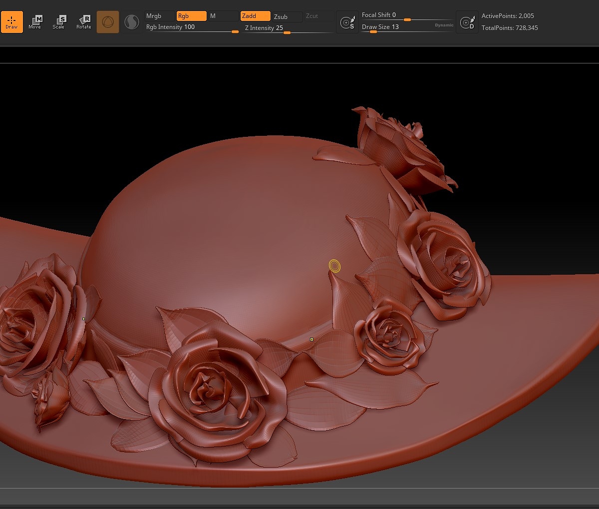

I wanted to replace hi poly subtools with lo poly models.
Accidentally, this worked perfectly fine for the very first subtool.
I had the subtool selected, and I imported an obj.
To my surprise, the lo poly model was placed perfectly at the position and in the size of the selected subtool.
A screenshot is attached below.
Then I selected the 2nd subtool and imported the same obj again.
To my surprise, the obj was placed at the position / size of the first subtool of that kind, not at the position / size of the currently selected subtool.
What am I doing wrong and how could could I do what I would like to do?
