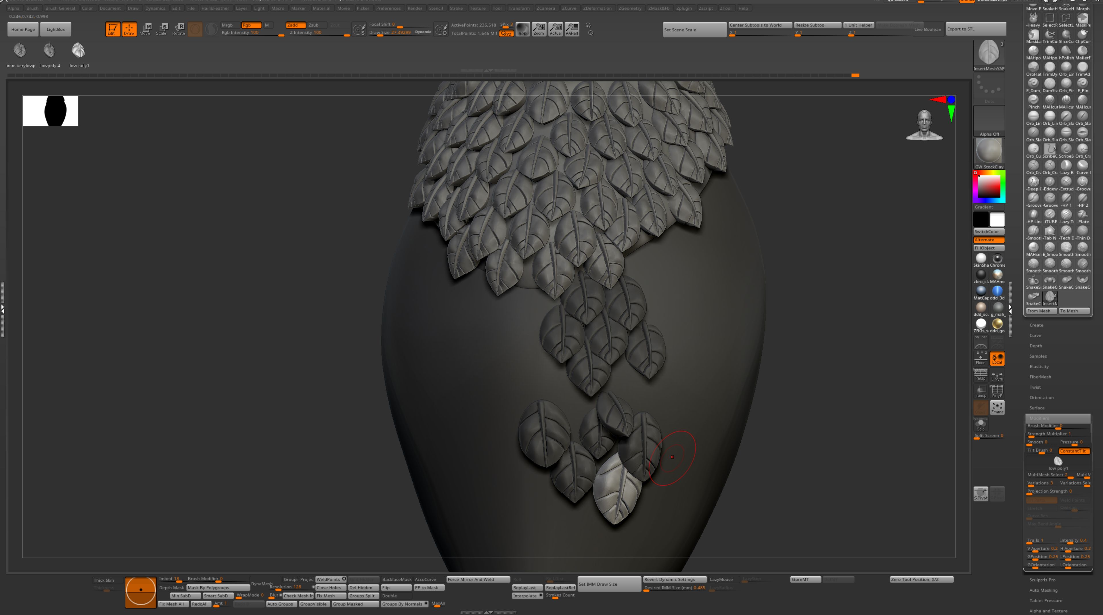

Hi all,
I want to use some feathers dıstrubuted randomly with same size , i dont know what is going on wrong but it, when i drag , then ctrl to right size after replacing it, it gives the same one, if i dont use ctrl (the very bottom feathers as sample, the ones on them used with ctrl that give me the ame feather .
Anyone knows how to solve this issue?
Thanks
Nubar
imm insert stuck|1000x557
I tried with simple sphere and imm brushes from z brush it gives the same result.
If i dont use ctrl for sizing the randomisation works fine , with crtl it keeps bringing the last one , i guess theree is a simple button to fix this issue cause like in the photo 3 weeks ago when i was focusing on the ptroject i didnt came up with a problem like that.

I’ve looked at this today. There appears to be a bug here or at least a behavior change I can’t account for. In previous versions of the program when variations are enabled, the selected mesh would cycle as soon as the stroke was completed regardless of whether Ctrl was used to constrain the stroke. For some reason when Ctrl is used now it prevents the selected IMM mesh from changing. You will need to change the selected mesh manually if working in this way.
Depending on the situation, Nanomesh may be a faster way to go about this.
I’ve made a note of this issue for the Development team to take a closer look at.
Thank you!
