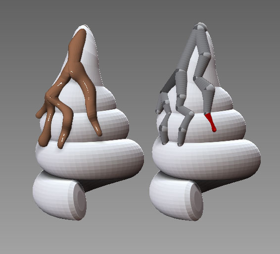

One way you could do this is to append a ZSphere as a subtool to your ice cream mesh. Switch on subtool transparency so you can see the zsphere, then scale and move it to the top of the ice cream. Now switch transparency off (this is essential): switch to Draw mode and you will now be able to add new zspheres simply by clicking on the mesh. Click then drag to scale the new zsphere before releasing the mouse/pen. To select a different starting point, hold Ctrl and click on a zsphere. This way you can quickly build up a mesh that conforms to your other subtools. When you are ready to sculpt, use the Gravity option in the Brush palette for greater realism!

1.Have the model you are working with (in this case the ice cream) selected and in Edit mode.
2.Click Tool: Subtool: Append and then select the ZSphere tool (the red ball) from the popup. This will add the zsphere as a new subtool.
  1. Select the new zsphere subtool in the subtool list so that you can work with it. You can model with it just like a regular zsphere.
