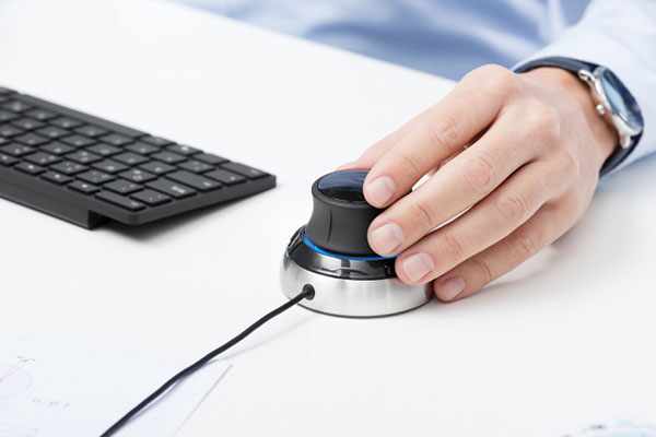

Spacemouse: image
You move the camera or the model with it. In all directions, with keyboard you can’t rotate all axis at once.

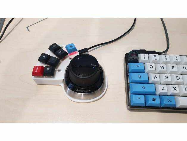

Now I wanna make it look like this:
But as you can imagine, the keys are in a bad placement. I don’t want that.
Probably not even that makes sense. I can only use my pinky for that. LOL.
I think it is very unnice if the keys are on the table. It’s hard to reach the keys in that case. I think the keys should be somewhere at the top of the spacemouse.

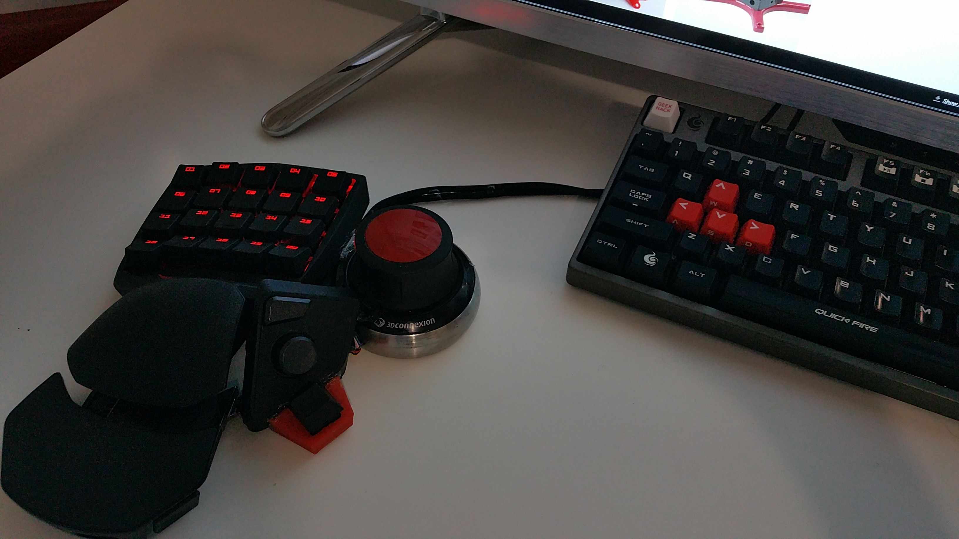

I’ve gotthe SpaceNavigator, and that has a couple of small buttons, one on either side. I’m sorry, I can’t see if yours does or not. If it does, are you wanting to use these too, or are you wanting everything to be on “keys”?
It might be a good idea to look at the current and historic 3D Connexion range, to see where they have founds to be effective to place buttons. Might give you some pointers?
