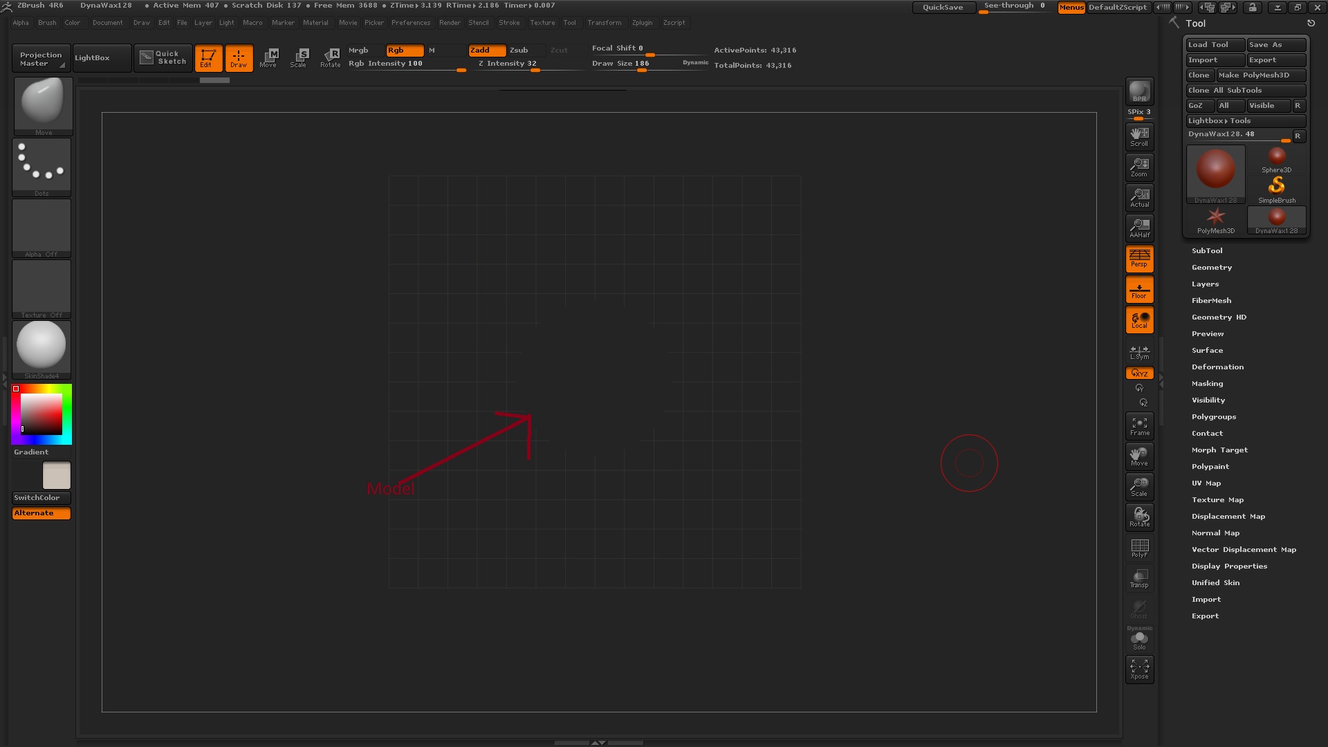

So the problem is: I accidentally pressed ‘Ctrl+f’ then I pressed ‘Ctrl+n’ trying to clear the document and placing
my tool again. But when I did it was the same colour as the background. I can still edit the model, but I cant paint
or remove the colour, it would seem it has no materials.
I tried starting a new project, but it seems this problem persists to every new project as well.
Here is the result:
I could really use some help with this.
It would help if you update to ZB4R6 P2. ZPlugins:AutoUpdate. And then by reading a bit more about paint and materials. If the object has a mask, it can’t be sculpted on or painted. If there is a texture map applied, polypainting isn’t going to work as expected either.
Thanks for your help.
I had already looked if there was a mask but there wasn’t. I tried restarting Zbrush and
it seems that fixed my problem. I m going to update soon, been awhile since I last used
Zbrush.
Thanks for your input anyway. :slight_smile:
