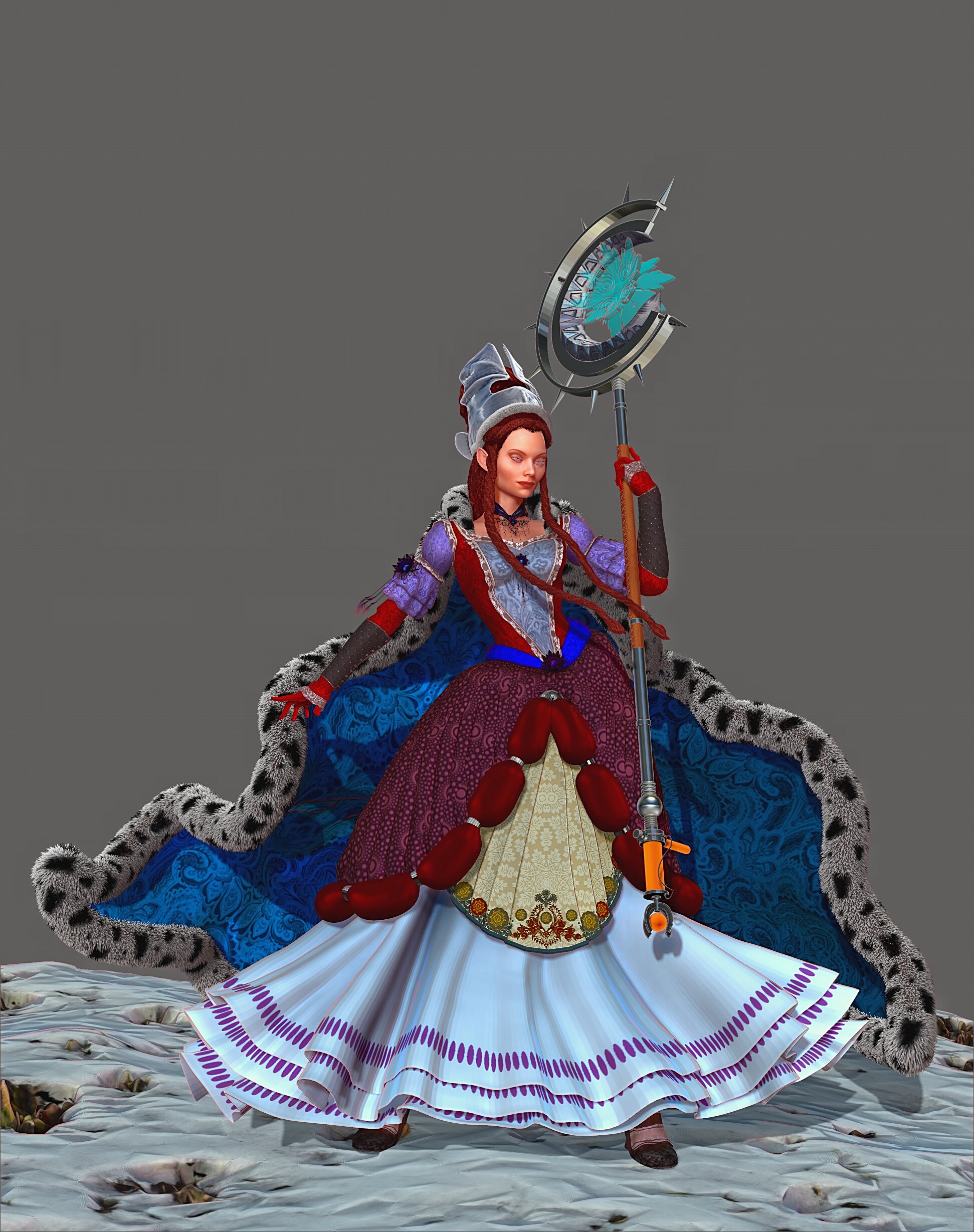

I can't remove 2018 materials, even using FillObject with flat color, in ZB 2019

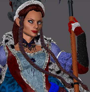

Additionally when I fill object with a Material or even Mrgb, it doesn’t stick and just reverts to whatever material is being used currently, as if it had not been FillObject-ed. I can’t remove the shiny shiny from the braids, consequently it doesn’t match the hair it’s supposed to be a part of. Is there an old lightcap on the object or material I need to remove (and how do I do that?):

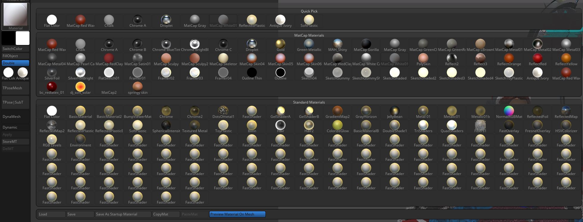

Moreover, there’s some weirdness with 80 some odd of the same material under standard materials:

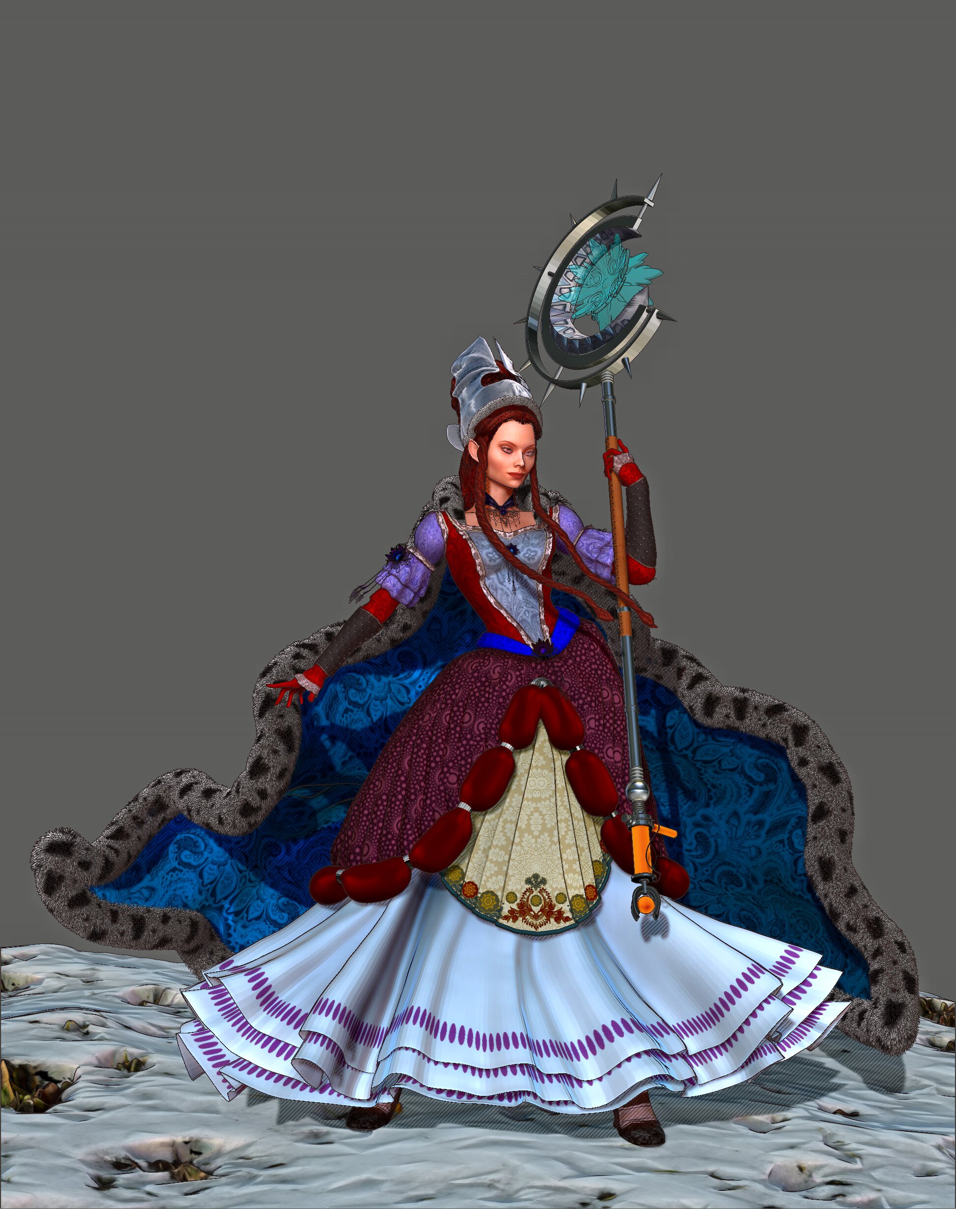

I tried turning off the lights in the scene, and this was the result:
No object has masking active BTW. Also the 2 tones of metal in the staff are another example of materials that won’t change even though they too are supposed to be the same material.
I’m going to ask the obvious and have you tried turning off the colorize object in the polypaint menu to see if you baked the old materials into these subtools? If you turn off colorize and you’re still not getting the material that’s active in the material palette to show up then you’ve baked polypaint and material info as the shader for that subtool. If you baked them you can try to get around that by deleting your UV’s on a duplicate of the subtool and clearing any texture in the texture menu, just to see if that clears the problem then copy and paste UV’s from your old piece to the new clean one and replace it that way. I mean that’s what I’d do and if that doesn’t work I don’t know as I’ve never seen that issue with all those copies of a material in the material palette before something else may be going on. And if so maybe someone else who has run into this knows.
I’ve fixed the weird standard materials duplicates by copying in materials from 2018.
To somewhat fix the braids that would not change materials I went into the material modifiers and copied a shader from white matcap into shader 1 (S1) but I still can’t fix a material for the main hair using FillObject - and here’s the weird thing; when I mouse over FillObject the popup box reads “Fill 3D Object Masked”.
Now the first thing I do everytime a new version of Zbrush comes out is to go to Shane Olson’s 3D Character Workshop for his interface - it is the only interface for me, to, perhaps, crippling effect. I probably couldn’t operate a standard layout without several days of adjustment. But I highly doubt he edits any popup boxes - can anyone tell me if the standard layout has this as well? And what does that mean? Because fill object sometimes works.
So, on most subtools materials (both with and without UVs and/or texture maps) materials can be changed and locked in using FillObject, but some subtools cannot have their materials locked down using FillObject and always change depending on the current material, and still others have materials that cannot be changed except in the material modifier.
I’m going to strip UVs from a duplicate for subtools with ‘locked’ materials as you suggested - but I still am at a loss about subtools which will not allow materials to be ‘locked’ using FillObject. Currently I’m doing multiple renders for compositing in post, but multiplied by the number of NPR filters I want to use, as well as different BG and FG elements, well, I’m up to 86 renders for the main figure alone, without the ground, background trees and rocks or foreground snow and ice swirling…

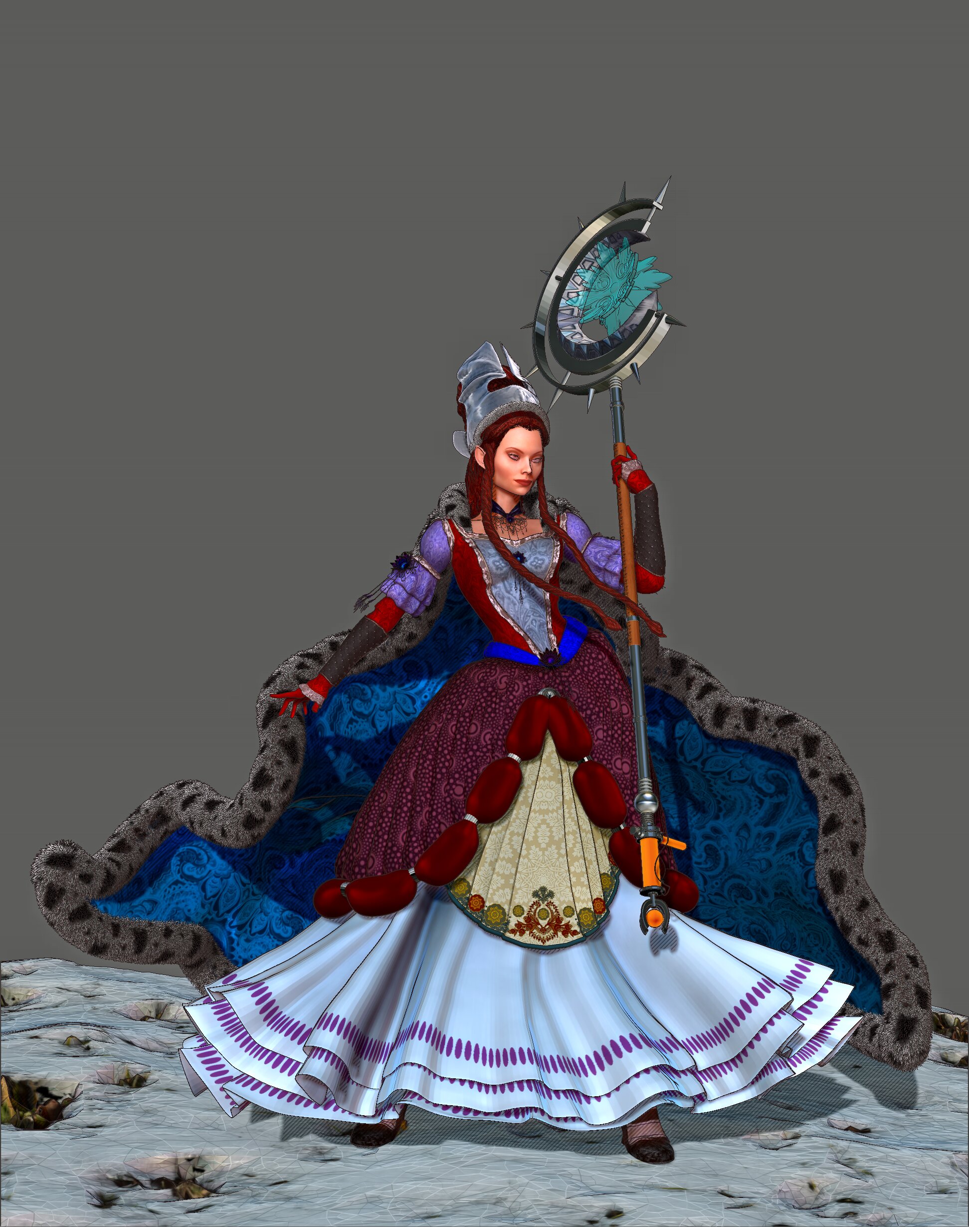

The method of duplicate and delete UVs and copy from original etc. seems to work well for ‘unlocking’ materials. However once unlocked, these subtools join the rest that will only display the current material - EXCEPT if the subtool has no texture. I think. I was finally able to get the fur trim on the cape to accept a material, so there’s that.

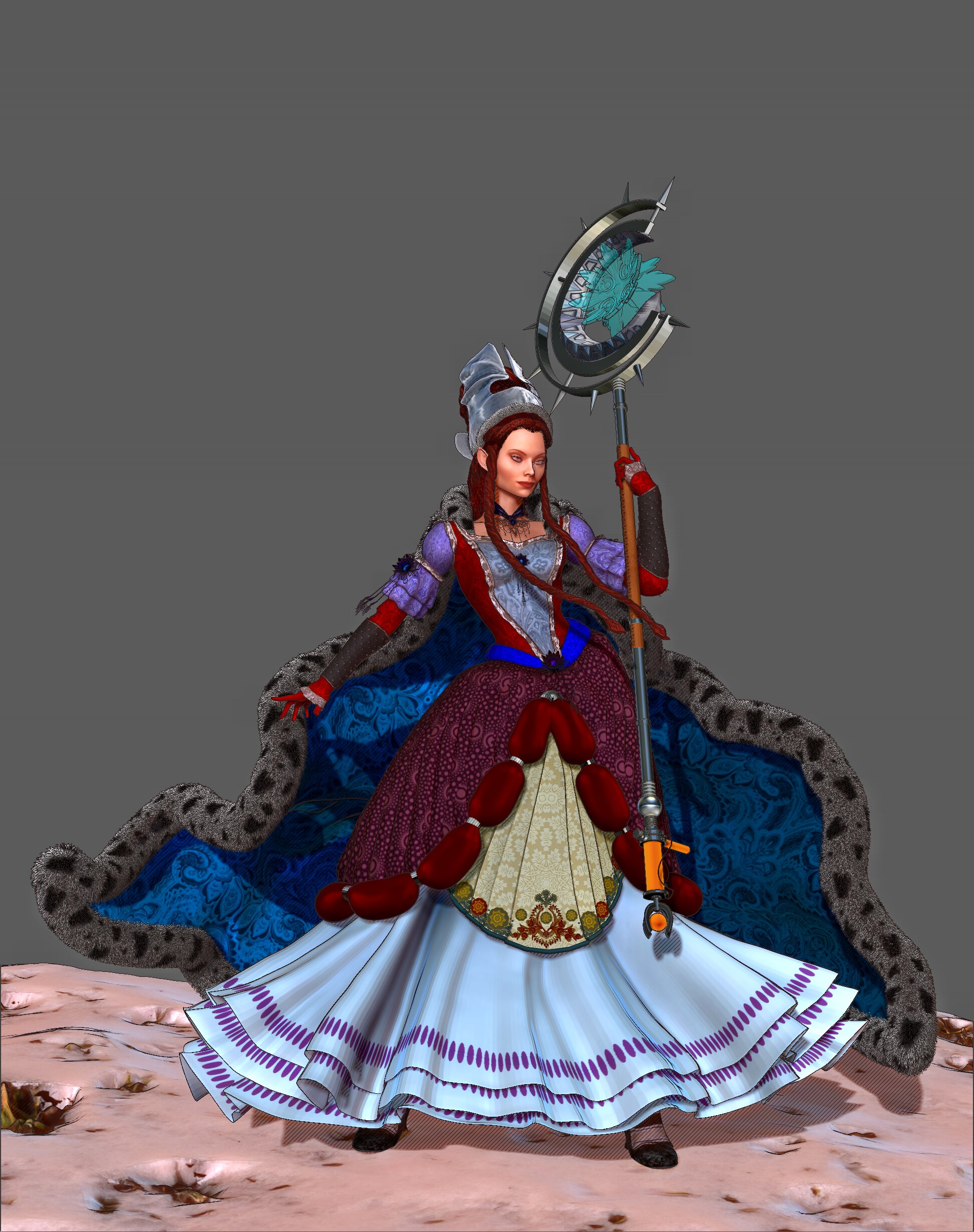

The snow covered ground is the problem - the other unlockable subtools look good with Haz_Rimlight_Skin but pink snow just looks like strawberry ice cream. So I’m gonna pump up the subdivisions and polypaint from texture while a suitable material is applied - see if turning off texture works. Oh yeah, matcap or standard makes no difference in this problem.
I also am dogged and patient, but this is wearing me down…
Okay…that worked. So having a texture on a subtool keeps it from retaining a material? Is very confuse.
Of course that 3000 point subtool is now 1.8 mil points - not a practical solution, really.
Just for fun, while at high subdiv, I create\Texture Map
ew from polypaint\ (automatic Texture On) and lower SDiv down to 2 from 5…and it retains the material now. WTH

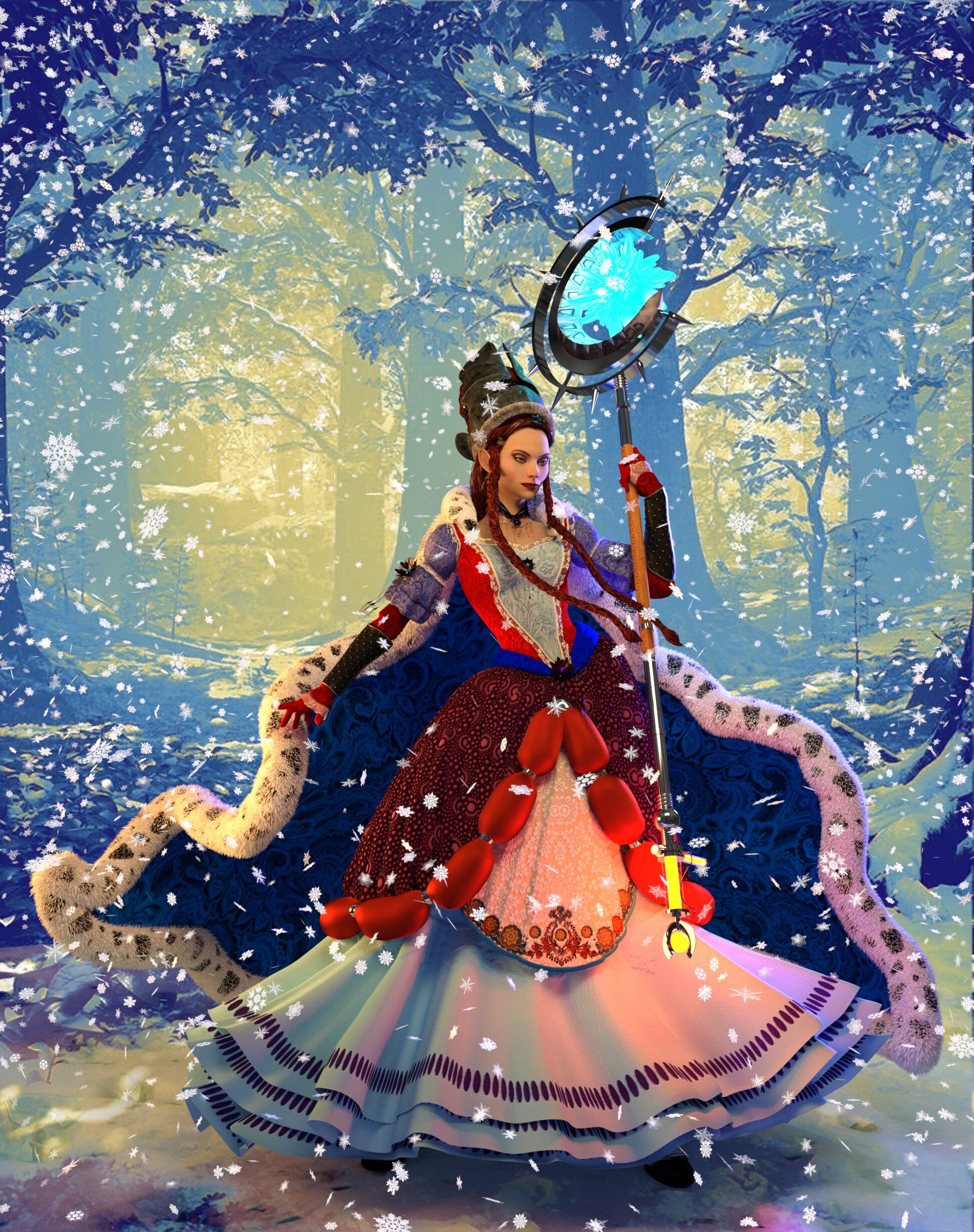

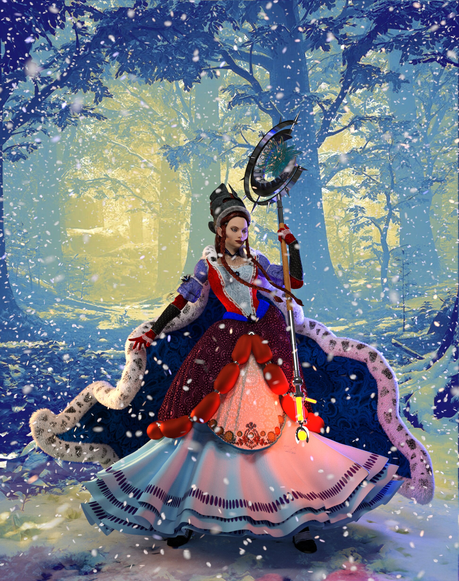

Thank you for that clarification - I didn’t realize using polypaint from texture also baked the matcap info as well…also read some technical stuff about how all materials in ZB are actually the flat color mat but then the other materials are just emulated through that flat color? I did a KeyShot render, thinking to make an end run with the new universal camera to use clownpass for compositing. But this camera was as jumpy as it was in Zbrush - whenever a subtool is loaded the camera would jump back and go to AC (autocrop) in Zbrush, and when objects are hidden or unhidden in Keyshot it would flip out similarly, which resulted in a slight misalignment when adding geometric lights:
This is an attempt to composite ZB NPR and KS images, you can see a slight alignment problem at the bottom of the skirt (the thin white line). Even with the camera locked and saved in KeyShot 7 I still had to realign by eye after each time a light was added or moved - lights which you can hardly tell are even there for all the effect they have. Compositing the NPR images from ZB looks good, but there are no emissive materials and lighting is hit and miss when using matcaps:
A real problem is when I try to bring in the snowflakes from DAZ - if the universal camera is within the sphere of the largest dimension of the largest subtool it will go to AutoCrop, basically back to ZB’s old 2.5D camera. So to move it far enough away to prevent this it’s going to basically look telephoto, having to dolly so far back and then zoom so far in to avoid the AC:
Daz Studio IRAY just looks so…Daz. Plus it takes over 2 hours to render a 1/4 size image - this is for RedBubble graphic tee, which covers the entire front panel of the shirt, 7770x9830 pixels - Zbrush BPR tops out at 8K, but it’s close enough. I can see about taking it into Marmoset Toolbag 3, but I’m starting to wilt thinking about adapting the textures and lighting for yet a fourth program.
Okay, I’m just grousing at this point. Allow me to thank you for your time and effort explaining the idiosyncrasies of Zbrush materials - I’m going to take a run at making a render without worrying about compositing with other programs’ renders - mebbe replace the matcaps with standards so I can get control of the lighting using a lightcap…

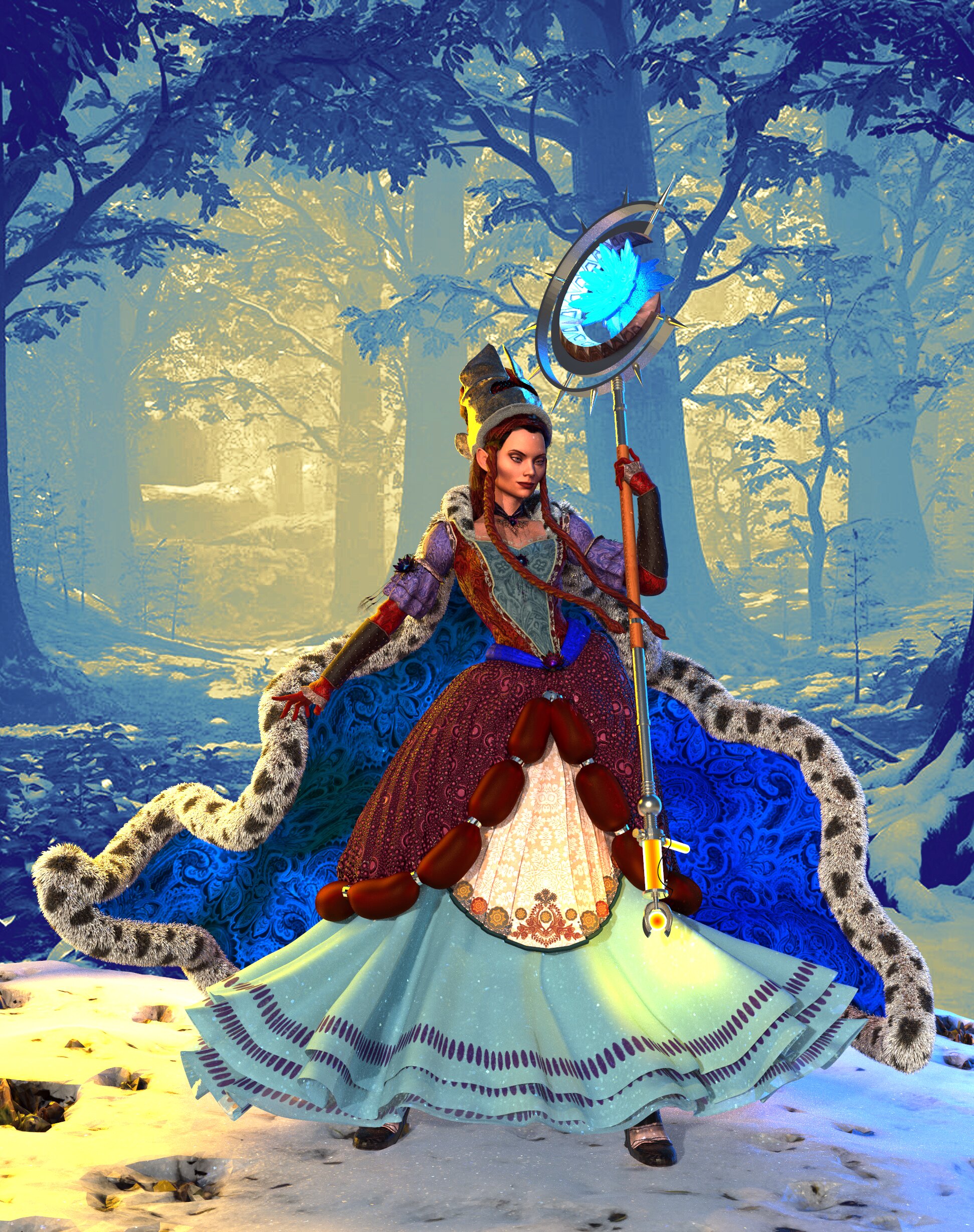

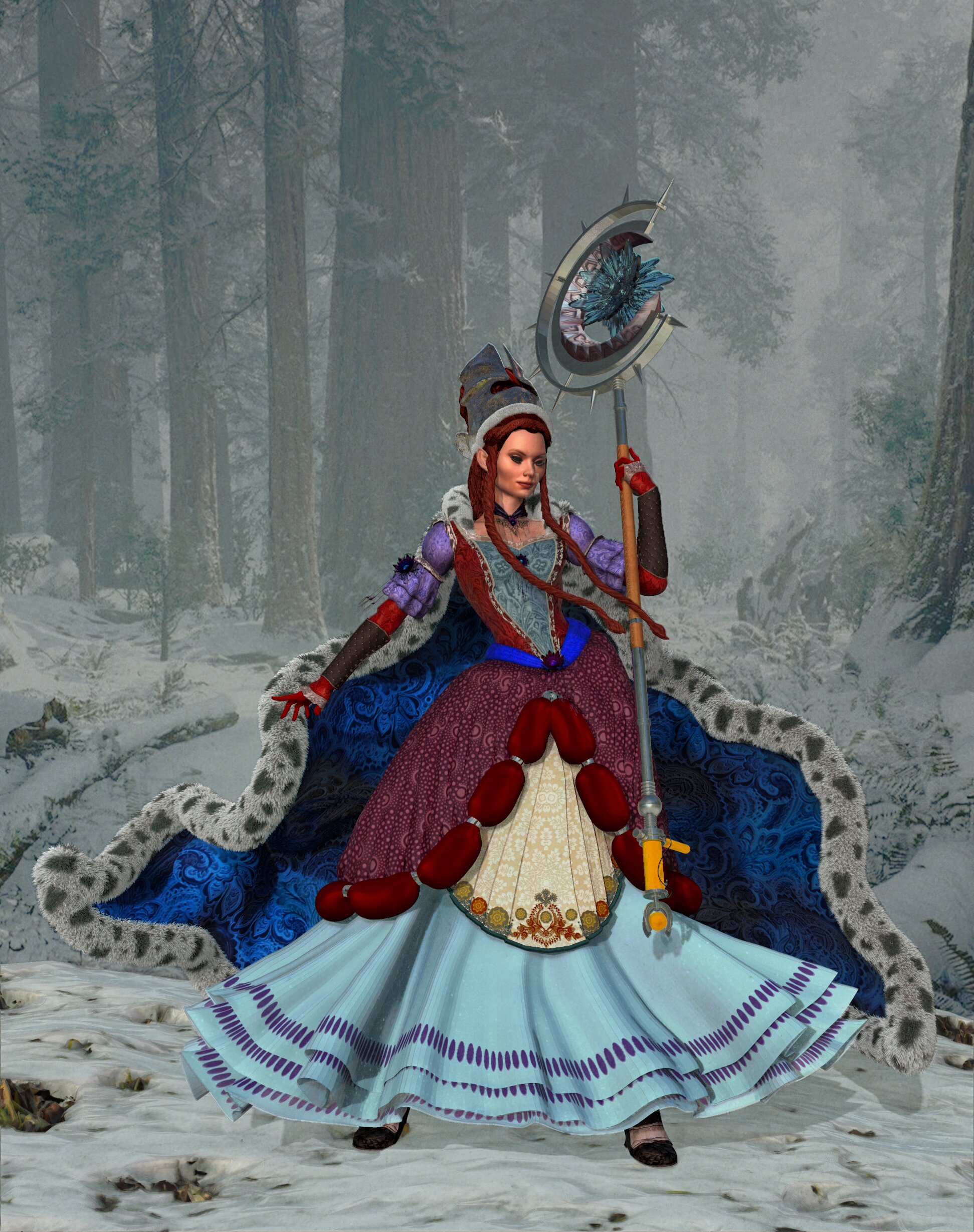

[FONT=Verdana]Okay, I remembered a bit more (and learned a bit more) about lighting in KeyShot - although the imported camera is still acting weird - I’m currently working on getting the snow in there (have to move the lighting planes out-of-frame so that the alphas on the snowflakes aren’t visible) then I can experiment with DOF to replicate the effect that I like from the DAZ renders:
[FONT=Verdana]
The DOF effect I like for the snow from DAZ:
[FONT=Verdana]
The cameras are close enough (between Zbrush and KeyShot, not DAZ) that I should be able to composite the elements I want from each programs’ renderings.
