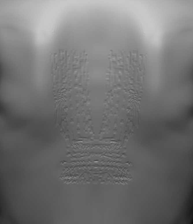

What I am wondering is how he sculpted those perfect muscle fiber lines. They look very fine and are all parallel. The tool he suggested is Rake (no alpha). If I try to follow his instructions, my muscle stucture does not look the same.
Is it a question of subdivision (I am at subdiv level 4; 1.3 mln polys) or do I have to modify the brush? Does anybody have a hint for creating muscle structure on such subdiv level, as I would like to avoid more polys?

I’m not sure what you mean by no alpha with the Rake brush. It has an alpha and won’t produce the parallel lines without it. Can you show a screengrab?
Sorry marcus_civis, you’re right. What I meant was that I did not change the Alpha.
This is the result I get with horizontal and vertical rakes
OK, that’s great, thanks for posting the picture. The problem is most likely lack of resolution and you will need to subdivide at least once more.
Dividing once more will give about 5 million polys. Is that really too much for your computer? If so, then you could perhaps use HD Geometry to get the detail.

No, it’s absolutely not a problem for my computer in terms of working within ZBrush. But I’d like to export the model into Poser and there things slow down significantly if I am going to subdivide more. I will try out HD Geometry tomorrow and I will post wheather it works better or not.
