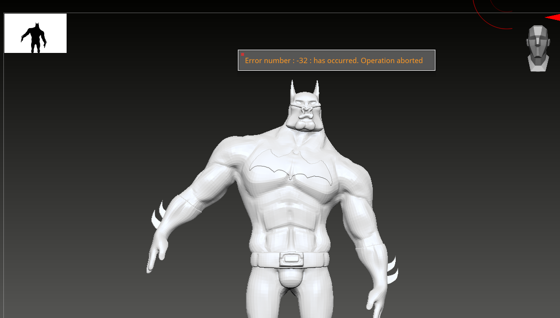

Hello i want to pose my model using blender. i successfully exported lowpoly model in blender to pose using transpose tool and imported back again the posed model in zbrush. but when i click “Tpose|SubT” To get my highpoly mesh together. i am getting this error. any thing i can do to fix this? i have a paid addon for blender which can rig a model really easily. it would be very helpful for my zbrush sculpts to pose.
Hello @khatri3d
This usually indicates the point order of the TPose mesh has been changed in some way. Something about your process has probably altered the geometry of the TPose mesh. Any questions about the use of your other software need to be directed at resources devoted to that software.
Remember that Transpose Master simply automates the process. As long as the topology is the same, you can import a posed, low poly mesh into a subtool with multiple subdivision levels at the lowest level of subdivision, and that will update the pose of the mesh at the highest subdivision levels too.
you are right…2 or more subtools were dynameshed while other subtools were zremeshed. that is why blender was messing up something. after zremeshing all the subtools. this time i used GOB addon and it worked like a charm
