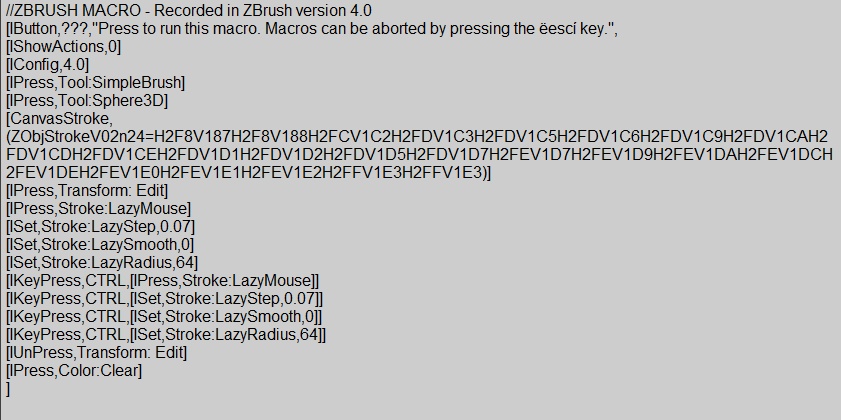

You just had to edit the macro text file appropriately (see diagram)
I have included a macro file that you can download. What the macro does is draw a sphere on the canvas, makes your lazymouse settings for both normal and Ctrl key press, then deletes the sphere. Put it in your ZStartup\Macros\Misc folder.
If you want the macro to run automatically at startup, then add the following line in ‘DefaultZScript.TXT’ file in your ZScripts folder.
[If,1,[IPress,Macro:Macros:Misc:lazymouseset]]
NOTE: The ‘lazy mouse set’ macro that I included in the zip file must go in your ZStartup\Macros\Misc folder if you add the above line in your DefaultZScript.TXT file.
