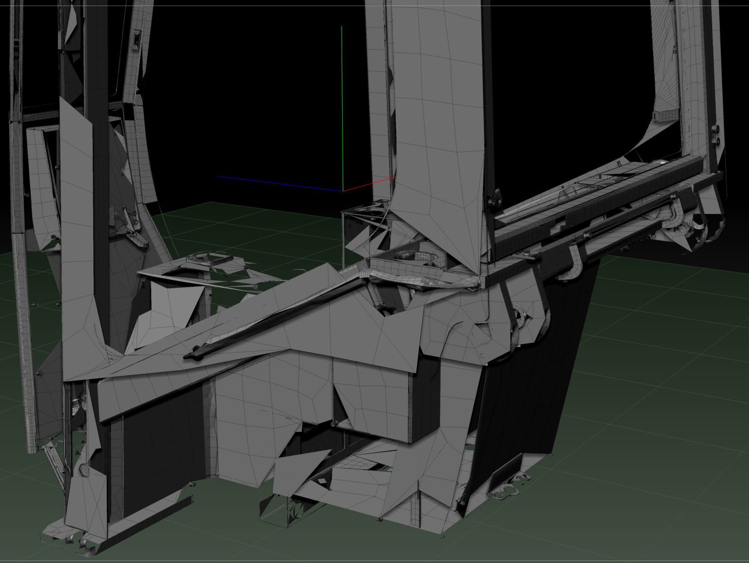

I am trying to remesh or dynamesh a complex model from Maya, which I exported merged as an OBJ.
It has a lot detail and subtools. and has no thickness.
I do not need to maintain anything else than the surface. The surface of course as detailed as possible.
Which is the best way to do this?

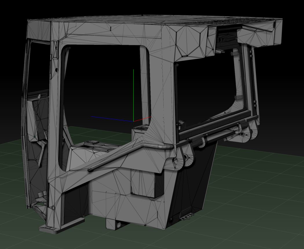

I was testing just an element of it:
  • when I zremesh it gets destroyed
  • when I dynamesh it disappears
  • tesselate is working but only increasing the number of vertices
    actually I was hoping ti get a quad topology
Any advices or at least other software to recommend?
Thanks
object 200K polies ZBR

ZRemesher can work on meshes without thickness, but yours is a hard surface mesh which has special concerns. Generally speaking, Zbrush works best on meshes that are closed volumes with a degree of thickness. You should always aim for meshes in this form if you want to work on them in Zbrush. It would make your job easier to extrude some thickness for your mesh, and delete the unwanted geometry prior to export.

However, ZRemesher can produce good results if your mesh shape isn’t overly complex. Unfortunately your mesh is fairly complex and has subtle elevations and fine details that aren’t likely to survive the ZRemesher process no matter what settings you use. These areas may need to be manually retopolgized with ZModeler and/or the topology brush, or reconstructed entirely on the retopo’d mesh.
