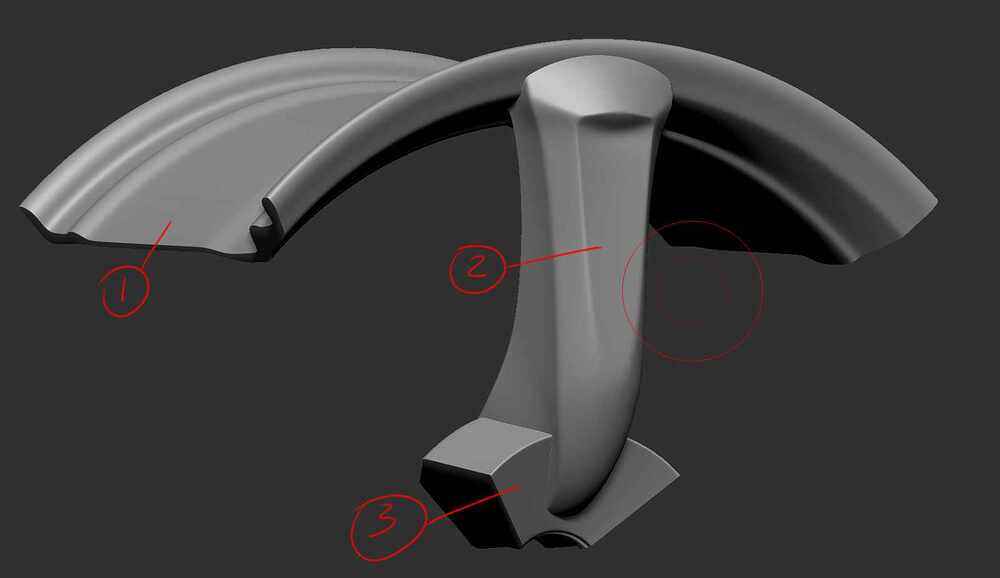

I started with creating a rim (1) a spoke (2) and the center (3).
So I am pretty flexible when it comes to changing a spoke style, or the spoke counts,
size of the rim, shape of the center, etc.

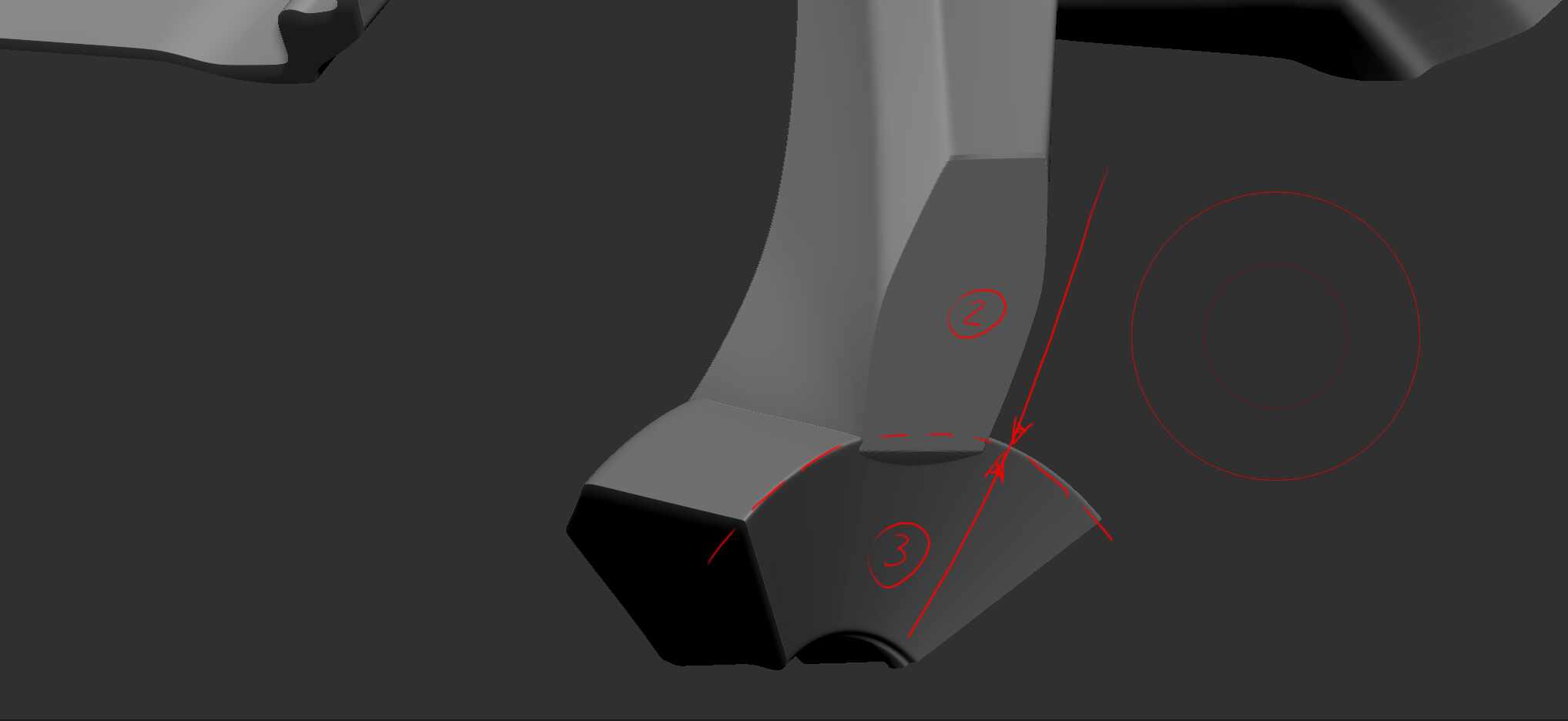

The point I stuck is the further step, after I set the design.
In detail, when it comes to the connections between this components.

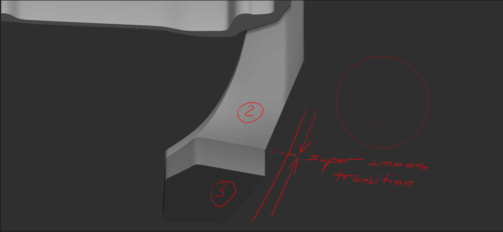

An other question would be:

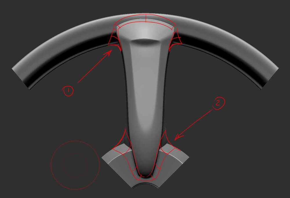

When I would change the styling of the spoke (2), and would like to let it fluently pass over into the center (3), how to achieve a super smooth transition between this two components?
Is there any tool that gives me control over it, or is doable either with some brushes intuitively?

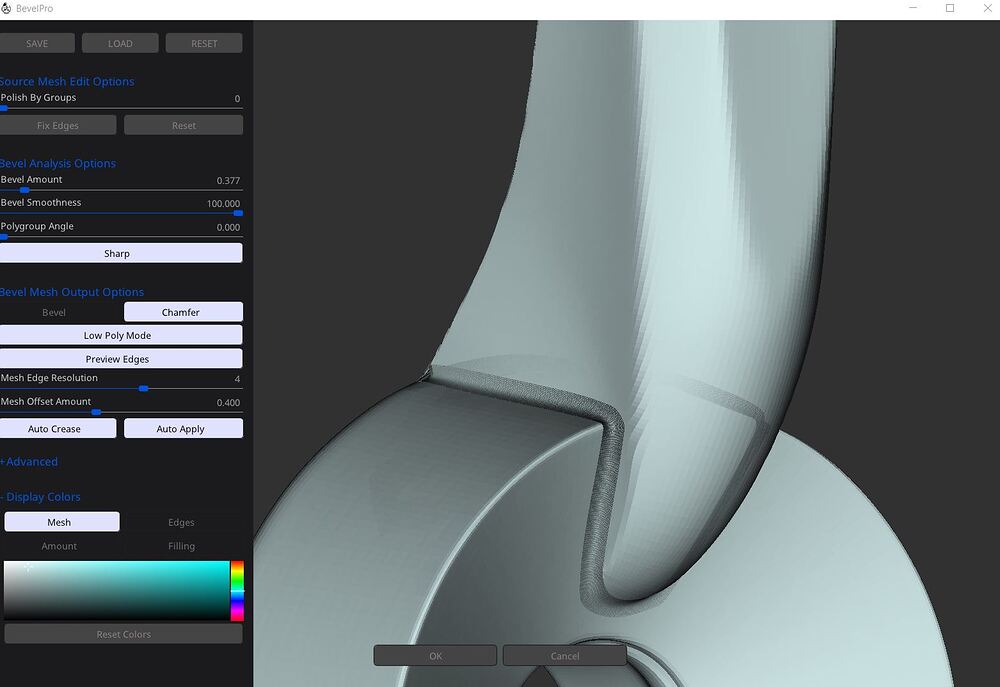

A quick and dirty approach I might recommend here when working at higher poly is to use Bevel Pro. Bevel Pro can create bevel geometry to serve as transitions for complicated mesh intersections. These can be applied to the mesh to change it directly, or imported back into the program as a subtool to be used in a non-destructive Live Boolean process. All you have to do is group the the sections you want to create bevels between into separate polygroups.
You can then use ZRemesher to simplify and clean the topology, which can be further subdivided and smoothed.

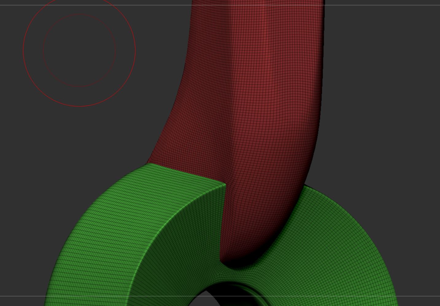

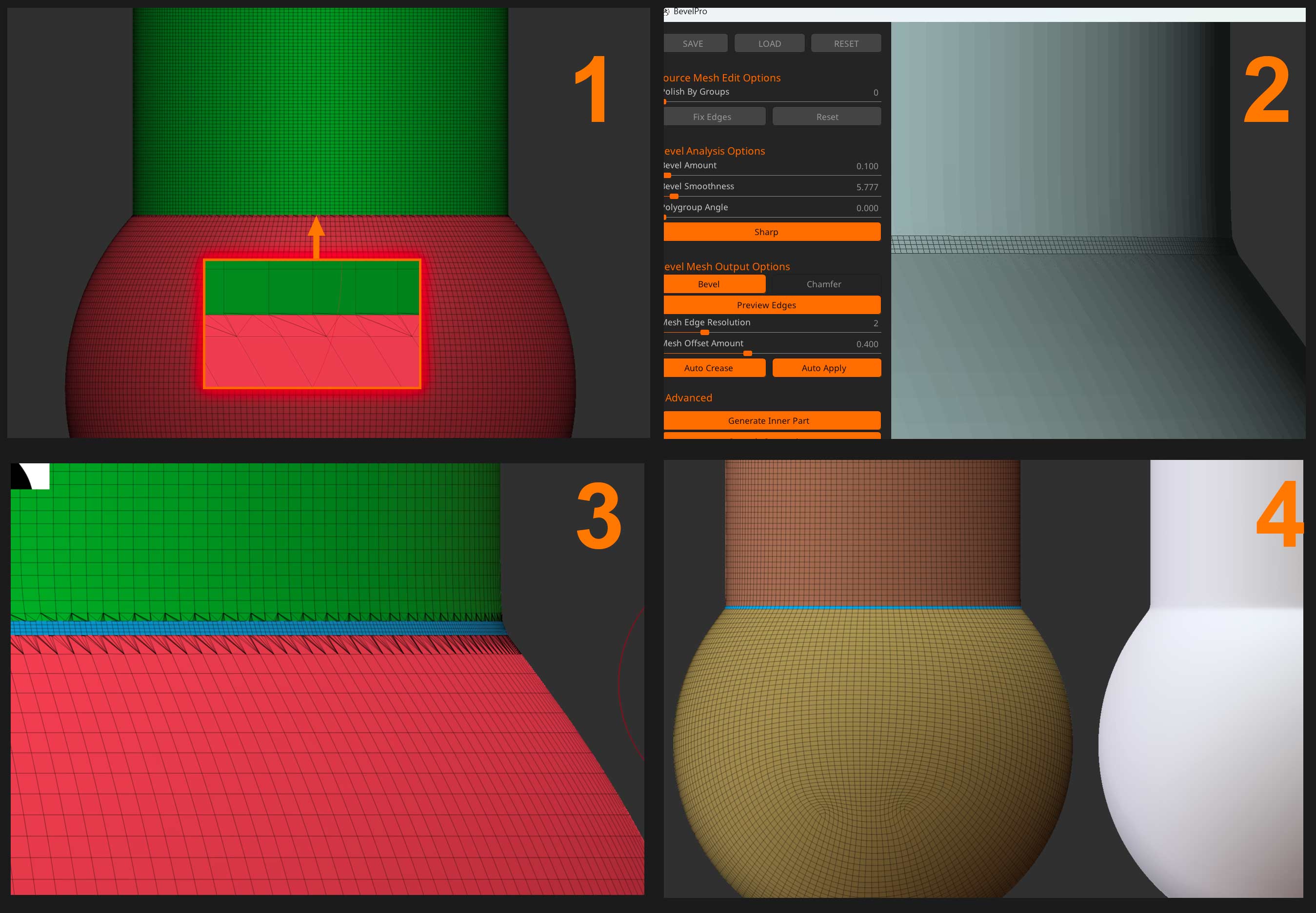

Please see the following image, and forgive me for creating such a simple usage scenario. The problem with this simple case could be easier solved a half dozen other, faster ways. Your problem is that you are fusing separate pieces of high resolution geometry with a very complicated intersection, and don’t have access to clean, simple edge loops to edit the polygons directly with modeling operations. I am merely using this case to illustrate the process.
  1. In this image you see we have two primitives that have been fused together with Live Boolean. This leaves the topology mostly unchanged, but creates extreme triangular geometry at the intersection. This type of geometry will cause problems when attempting to sculpt, smooth, or subdivide it. Unless you are simply going to decimate and export, you may want to clean this if you are going to work with it further.
  2. I use Bevel Pro to create the transitions, apply changes and hit “ok”.
  3. This is the resulting mesh. You see the same problem geometry at the intersection. If you’re going to do anything else to this mesh you will probably want to clean it up, and doing so will provide you with more opportunties to smooth and shape the geometry.
  4. I use Zremesher with the Keep Groups option to simply the geometry and return it to clean quads. Main points here:
  • ZRemesh at high target polycount to start, then reduce with “half” option until you start to lose the form.
  • Local flaws in the topology are usually caused by tiny polygons near a border that may have a stray polygroup. May not be able to be seen unless you smooth the mesh. Use Dynamic subdivision to help you preview what the mesh will look like when smoothed. Being comfortable with Zmodeler will let you touch up problem areas on the fly.
Once ZRemeshed, now I have nice clean quad topology and clean edge loops that I can manipulate or delete to shape the transition further. Subdivide to smooth.

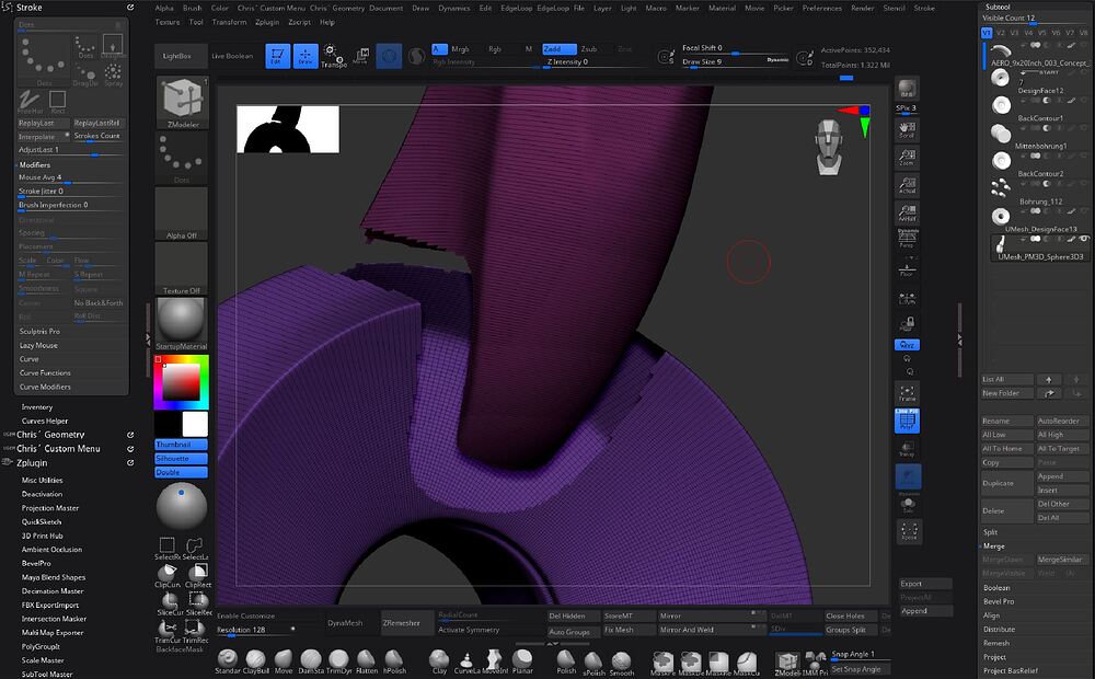

First of all @Spyndel I have to thank you a million time.
I don´t expect such a deep and detailed reply with all your inputs.
It must have take you some time to think in and rebuild the scenario, screenshot it and describe. Thank you soo much, that´s really friendly.
I know all the tools you mentioned, but for me it was really helpful, that you put in the pictures and the numbers, which step to go in process. Also it was really helpful that you explained why to do so…

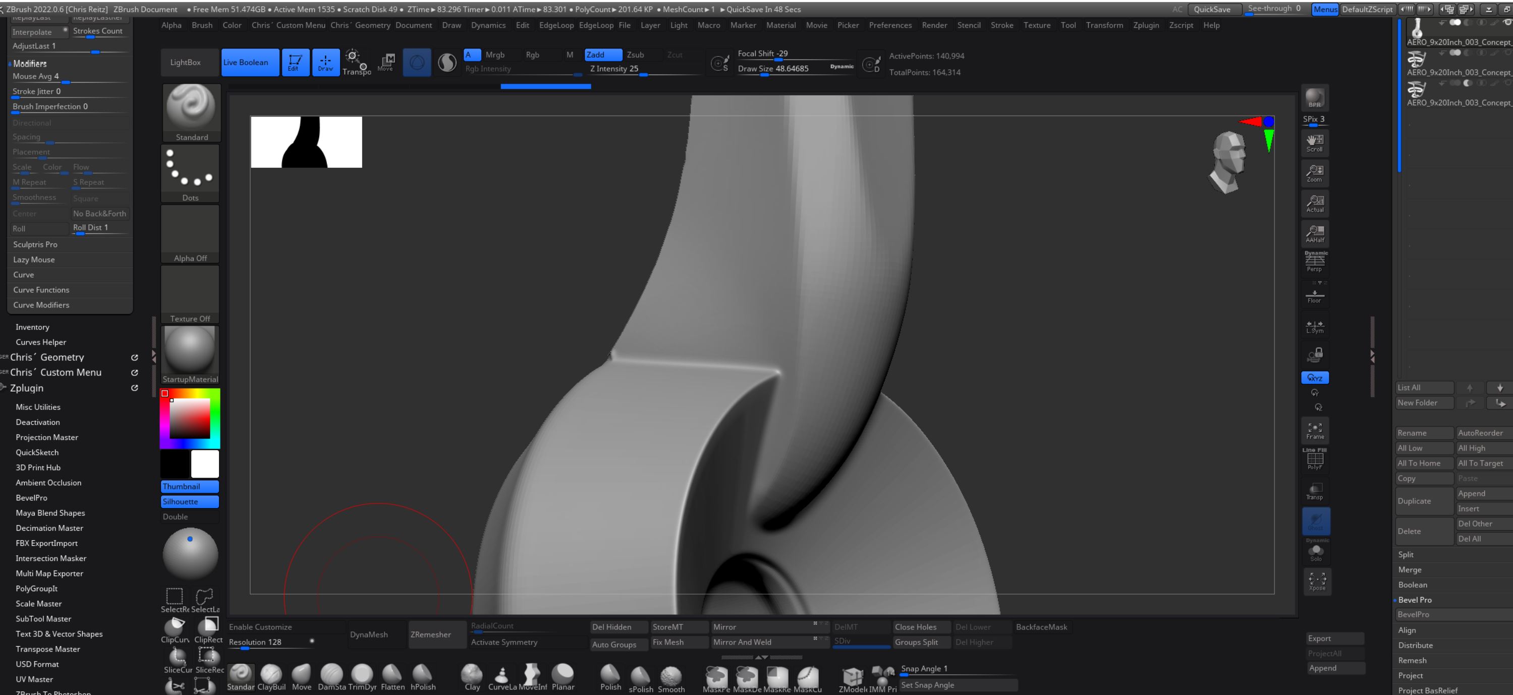

After that I come up with that result…
So I know for example, that I need to substract the back contour at last. You see the irritation on last image left hand side.
But that shouldn´t be a problem, when following one step after the other in process.
Nevertheless, I think, I will use that workflow for more detailed situations, like the boldholes-fillets for the screws and similar stuff, which is well defined.

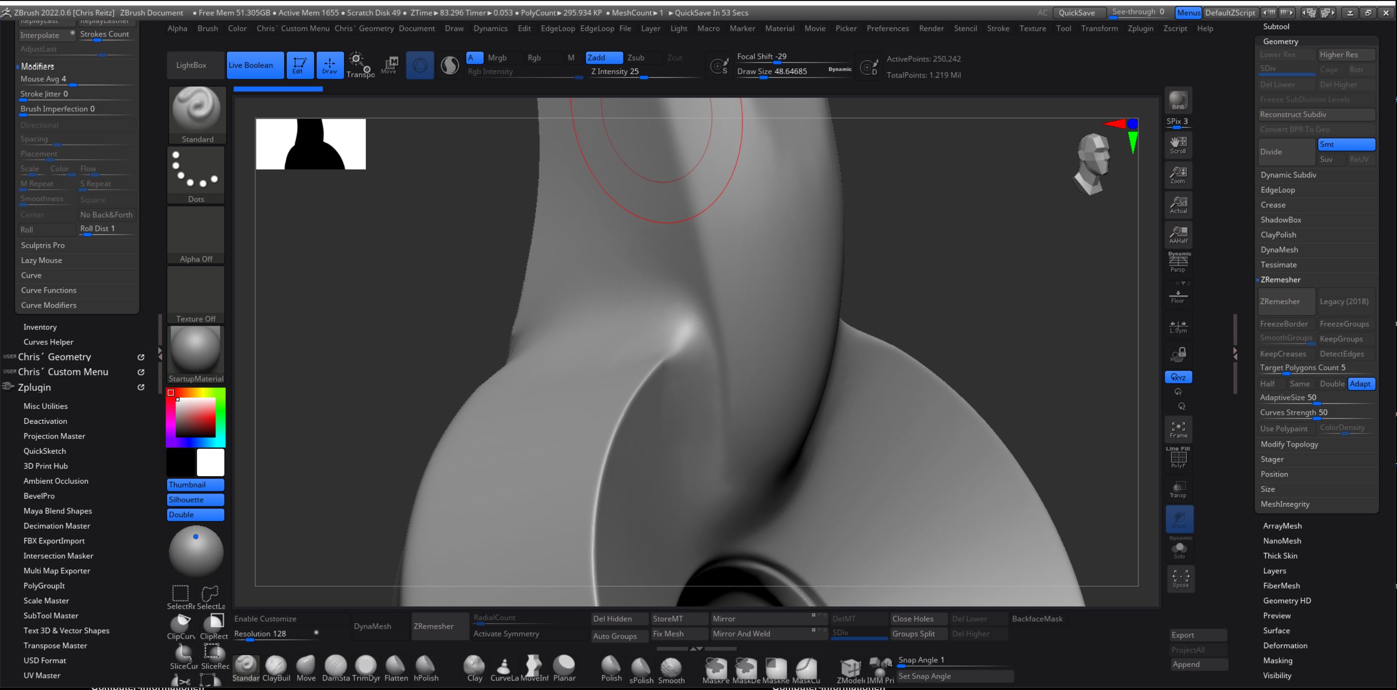

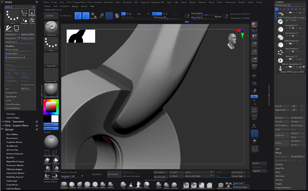

I find another quick and dirty solution for concepting here:
So I could even paint the part which should have a transition.
I can easily mask it in witdh an bridge it. After that I just smooth it.
That worked quite good for me:
And I did that really quick just for test tasks.
Guess if I would put a bit more time in, it will get excactly what I am going for.
It is of course not the sophisticated solution you recommended, but I am pretty sure I will use both of them in the future. And therefore I really thank you a lot.
Helps me to choose the right solution for any task.
Yes, you´re probably right here.
I think I would use the trim curve tool in the front view and cut the upper part.
It will need to have some space for a comfortable transition.
I would decide for the bridge tool to reconnect here as well.
The ZRemesher could here also be helpful to get both pieces in a similar polycount and therefore to a cleaner result.
So I am playing a bit around with all that tools to find a intuitive and flexible solution, which is also clean as possible.

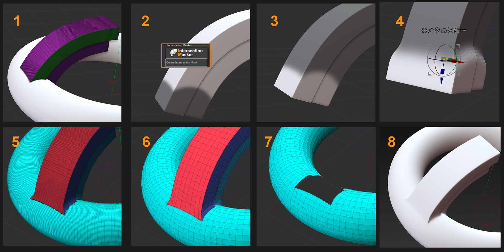

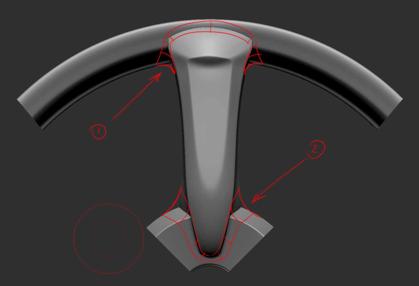

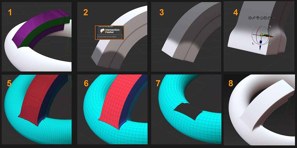

Let me introduce you to one more feature that may be of use to you here. The Intersection Master plugin can be used to create a mask where two pieces of geometry intersect. This may allow you to more accurately shape a mask to fit the contour of the target surface in a high res modeling situation…
Please see the following image:
  1. You will need a medium-high resolution mesh with well distributed quads for the end to deform properly and in order to produce a good quality masking edge. So In this case I have Dynameshed a somewhat complex shape in order to resurface the mesh and make it suitable for the deformation.
Something I have going for for me here that you don’t have in your original example is well-defined polygroups. You will see how this will pay off in the end.
  1. I merge the two subtools together and use the Intersection Master plugin. If you then split or hide the ring, you can see that the “spoke” in this case now has a mask that is perfectly shaped to the contour of the ring. The mask can be blurred and shaped with the various grow, shrink, blur and other functions in the Masking palette. You can shape the mask to get the falloff you want.
  2. Ctrl-click the canvas to invert the mask
  3. I position the Gizmo manipulator at the center of the unmasked portions. “Go to Unmasked Center” is one of the icons that floats above the manipulator.
  4. Live Boolean to fuse the meshes together.
  5. I did a quick ZRemesher with “Keep Groups” active to clean and simplify the geometry. Because I have well defined polygroups, that feature is able to convert the shape to high quality quad geometry with edges drawn exactly along the edges of the form. This makes the geometry accessible to low poly modeling operations as well as making it easier to work with in general.
I got lucky here and got really good results with my first try, though sometimes manual touch-ups will be necessary. Since I now have accurate edge loops and all my hard edges bordered by different polygroups, I can simply use the Geometry> Crease> CreasePG to crease all the polygroup borders with one button press. This will keep those edges sharp when subdividing.
  1. However, I don’t want sharp edges everywhere. We want a soft transition from the spoke to the ring. So I Shift-Click on the ring polygroup to hide everything else, then I use Geometry> Crease> Uncrease (open border) to remove the crease on edge where the ring and the spoke meet.
  2. Now I subdivide once or twice with the the spoke creased but not at the intersection. The spoke stays sharp but the transition is smoothed. Since I don’t want the edges on my spoke to be impossibly sharp, I remove ALL creasing then subdivide a couple more times.
This produces the highest quality results, because it leaves you with a multi-resolution mesh with high quality base topology, which is the most useful and flexible form for a mesh. From here you can go in any direction. You can go back to working at a high level of mesh resolution with sculpting operations, or you can edit the mesh with low poly operations at the base level. A multi resolution mesh will also eventually be required if you want to create textures or achieve the finest detail possible
