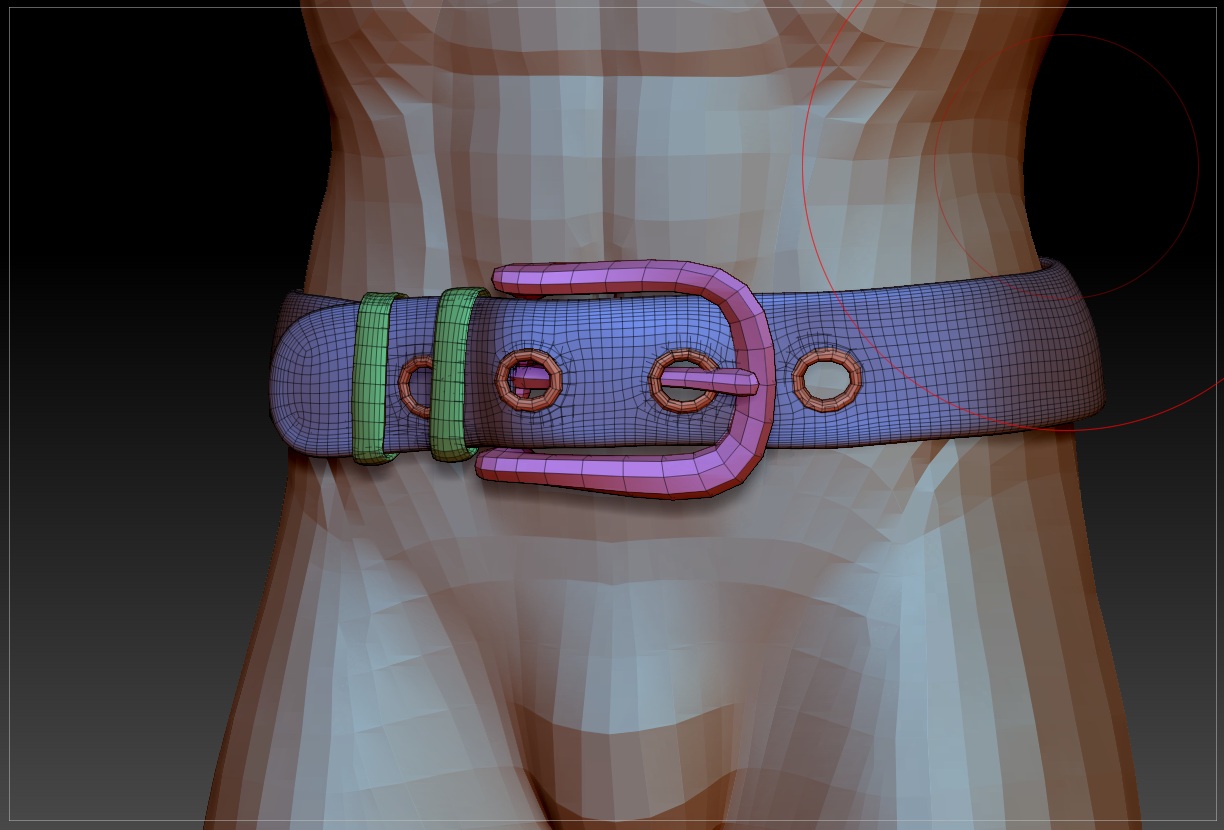

Well, thought I’d show you what I managed to do. Used masking, Visibility hid, Modify Topology - Delete Hidden, Edge looped them and then used the Deformation - Polish. Then QRemeshed and got a good hole. Finished them with torus. Looks pretty good.
Don’t know how to subtract using another object. Is there a tutorial for that? Might speed things up a bit! lmao
Your belt is going the wrong way, btw.
I would say that depends on if you left or right handed! lol
