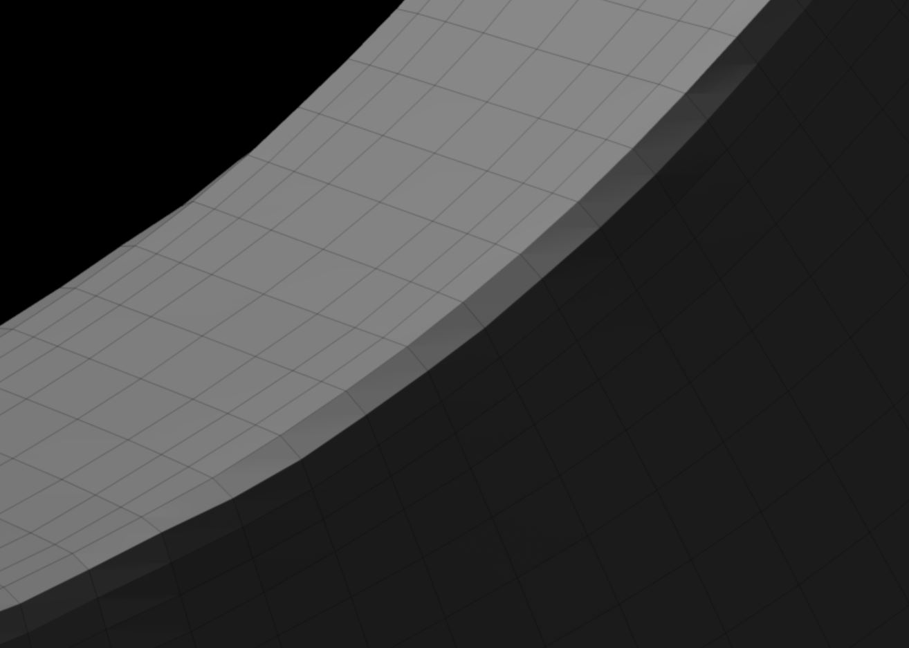

I have a “simple” task, I have already a basic shape, I only want to get it really flat from both sides, with a sharp clear border edge.
When I’m using zRemesh it always gives me soft edges
and technically there is also not a single edge on the corner, they are randomly going.
I already had a high resolution with dynamesh and cut out a flat piece at high resolution, but again, zRmenesher can’t keep this.

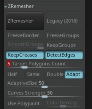

zRem settings

If you make sure that all of the sections on your mesh that you want to be separated by a hard edge are their own distinct polygroup , and then ZRemesh with the “Keep Groups” function enabled, ZRemesher will draw the edges between the polygroups. They can then all be creased with a single button (Tool> Geometry> Crease> CreasePG).
I find it works best to first ZRemesh with Keep Groups active at a high target polycount, so that ZRemesher can work out the form with plenty of polygons to spare so it doesn’t have to sacrifice form. Then, use subsequent ZRemesh operations set to “Half” to simplify the topology as far as you can before ZRemesher can no longer maintain the form. Some touch up work here and there will probably be necessary on more complicated meshes, so don’t chase perfection with ZRemesher. Get as close as you can, then touch up problem areas with ZModeler.
