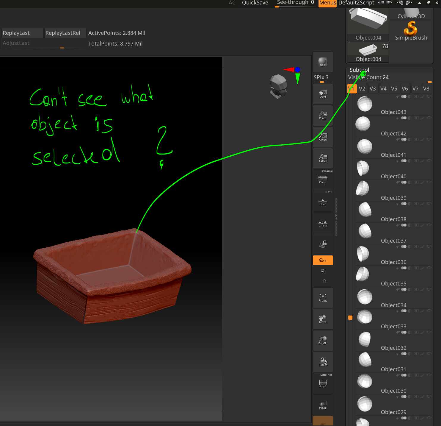

How To Highlight selected Subtool?
When using a lot of Subtools, I am always having trouble finding within the Subtools Palette, the object I have selected on my canvas.
  • Is there a way in the preferences, to make sure, when I select an object on the canvas, that his object is kinda “highlighted” within the Subtool Palette?
So it’s really “visible”.
Thanks

yes thank you, all those options do work.
However, I want to do something else.
I want to make sure, that “visually” I can immediately see within my SubTool Palette, what Subtool I am working on. Therefore, I would like to change the intensity and color of the “Highlight”.
  • How to change only the Highlight Color from a selected Subtool?
