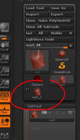

They’re still in the tool palette. The thing is it may be in disguise. The subtool that is selected will show up there, not the entire bunch of subtools combined. Give it a good name so you can load it again. :smiley:
The number of subtools is given in the thumbnail in the Tool palette, which can help you select the right tool again. The image shows the DemoSoldier (vest_1 selected) which has 11 subtools.

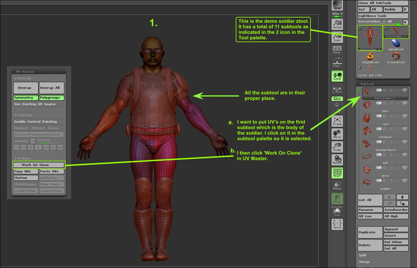

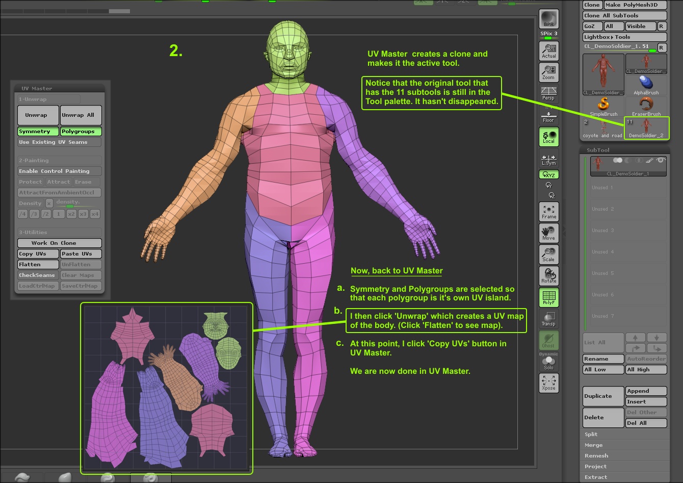

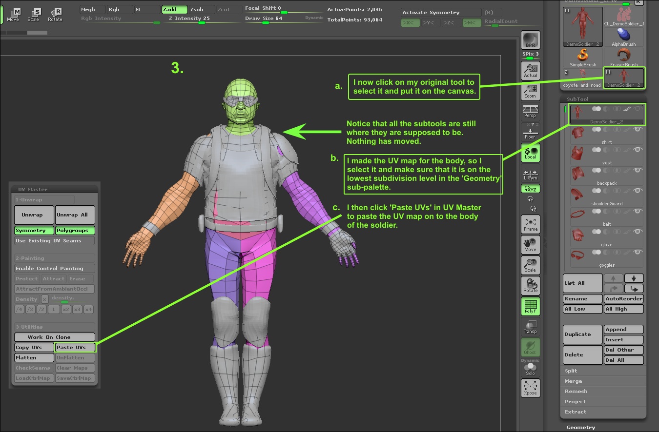

Just to reiterate what I said in post #4 because I have a funny feeling that you didn’t quite understand it. Maybe the following will help.
The body of the soldier now has UV’s. You would repeat the above for each of the other subtools. (another alternative would be to merge all the subtools and use the ‘Polygroups’ option in UV Master to have everything all on the same UV map).
