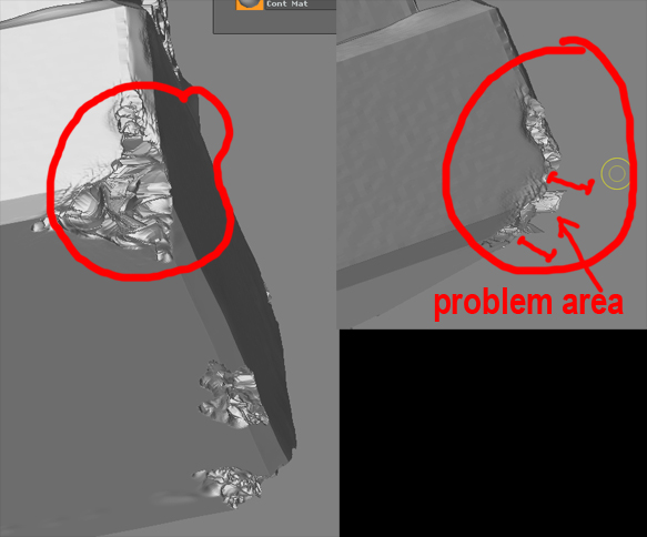

As you see in the image,
Try turning off Normalized in Projection Master. It looks like your problem is coming from the fact that the displacements are being done relative to the surface normals of the model. Since those surface normals are at right angles to each other, the effect is fighting itself. Turning Normalized off will fix this by making the deformations relative to the camera instead.
If you’re using ZBrush 3.1 you might also try using one of the many sculpting brushes instead of Projection Master.
aurick,
Thanks for the reply.
at the moment I’m using Z2.0…
Alright. Then the Brushes option is out, and you’ll just need to turn off Normalized in PM itself.
