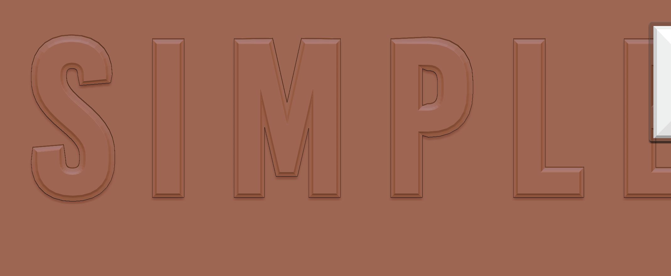

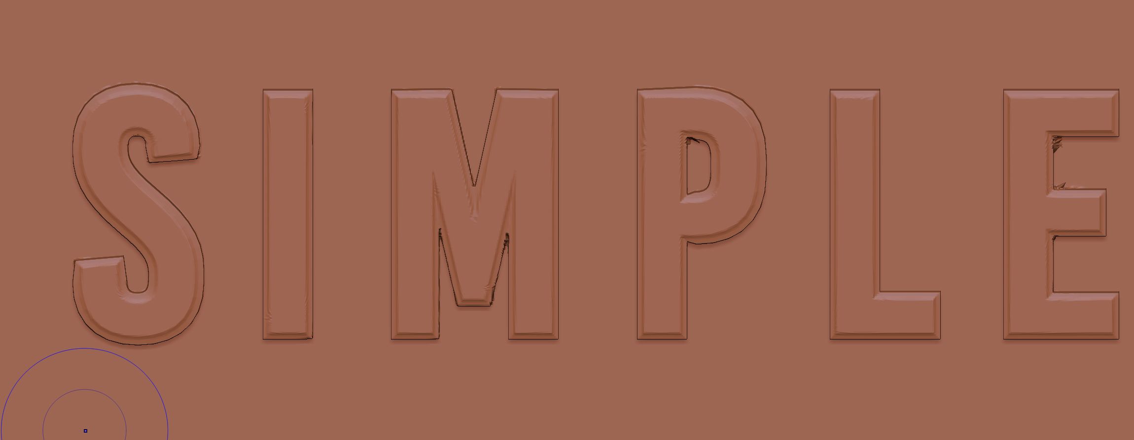

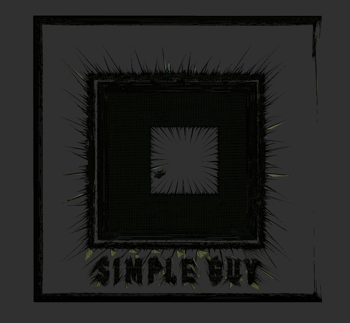

Okay, so I have to dynamesh it to get rid off errors in a topology to be sure that the model is clean.
I did as you advised with the zremesher but the end result is not that good (see the image before and after)
Here is an image of a dynammesh:
dm_01
Before remesher:
After:

I have no idea what’s going on there.
ZRemesher wont fuse any geometry, or fill any holes. You need to clean your mesh before using it, and make sure that any portions that are supposed to be fused together are welded.
Remember, your mesh needs to be a closed volume with thickness to work well with Dynamesh. Dynamesh will fill minor holes, but large open sections of mesh will return poor results. 2D surfaces without any thickness will not work with dynamesh.
