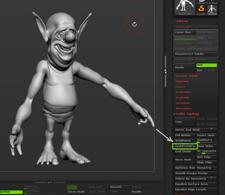

As soon as it’s drawn out, I went to: Subtool > Split > Split unmasked points… This puts it in its own subtool.
Unify is in the Tool > Deformation palette
thank you I did it like that first but later I found a better way, instead of splitting stuff putting different subtool and then deleting it, I simply ctrl+shift and dragged around the cube (my base object )then I used ‘delete hidden’ option :slight_smile:
