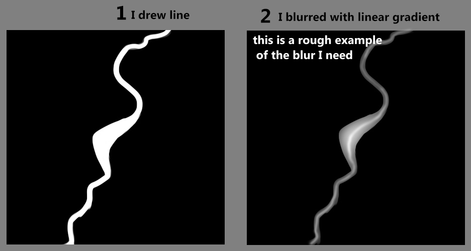

I want draw alphas manually at 2D software. I need sarp falloff for my lines i will draw. How can I achieve this?
Alpha note
This kind of effect I want to give to alphas that I will create

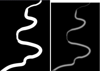

More Detail about my question.
2
1

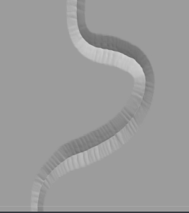

I tried do my stuff in photoshop using Layer Styles, Inner Glow with Presize setting ( presize setting is necessarily for our blur because soft option break your drawn stuff ).
Inner Glow works fine only now it creates artifacts - transverse stripes, below in the pictures I

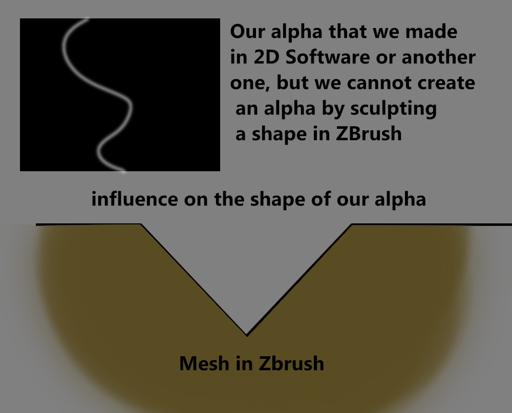

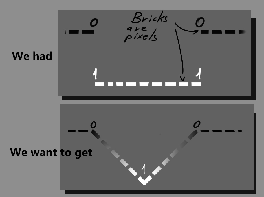

I am already in search for a Brush functioning as an alpha transfer (only for alphas with sharp b/w without gray) that performs with uniformly homogeneous falloff at edges which can be definded by a exact falloff spline in the brush settings.
A brush or brush setting that will give me the ability to apply an alpha to a layer (clear black and white alpha with no shades of gray) at all black and white transitions with a specific falloff.
Just think about this text lines hear as an complex alpha, which should be projected to a flat surface just to get beveled and maybe chamfered edges from top drawing such effects down to the ground of the surface !
The bevel and camfer effect should be defineable through Zbrush… possibly through a spline falloff dialog.
All just to make it easier … no need for complicated Photoshoping around.
The text example is only an example and should work on all sharp b/w alphas.
