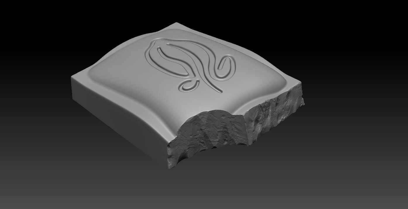

Hi everyone,
I’m pretty sure this isn’t difficult, but I’m new to ZBrush.
Can anyone suggest how to go about creating this kind of surface detail on the edges of the chocolate? (I found this on Pinterest and I’m trying to create something similar)
Thank you!

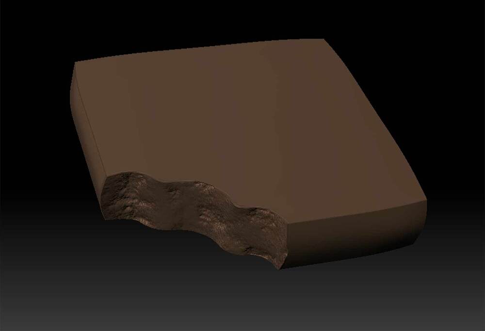

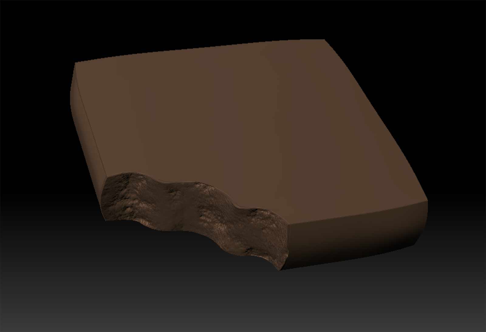

The following is a quick example without any artistry:
Good luck!
