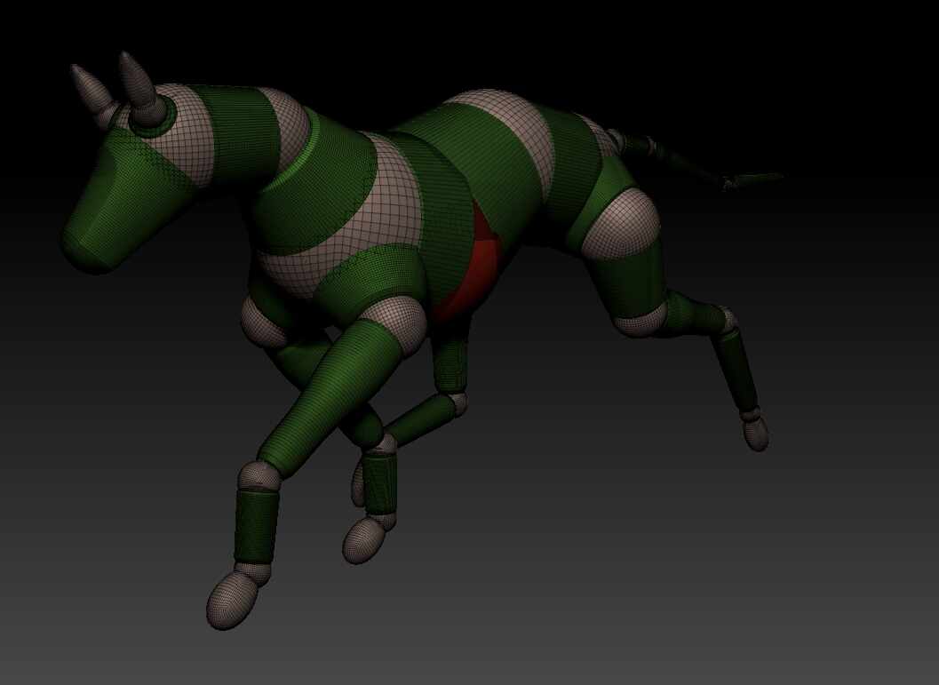

hi @Massimo_Petralia !
So to make such of mannequin using ZSpheres, you must first enable in Tool > Adaptive Skin > Use Classic skinning
Once you set that up, you can then create a more complex ZSphere rig, when you can then select a certain ZSphere and you will see two option available Insert Local Mesh, and Insert Connector Mesh.
so the first is to set a mesh on joint, and the second one is to connect two ZSpheres.
Hope it helps!
Nicolas
Thank you very much, I think this function is very useful and powerful for creating complex base meshes where there are joints to pose (such as those of the hands)
