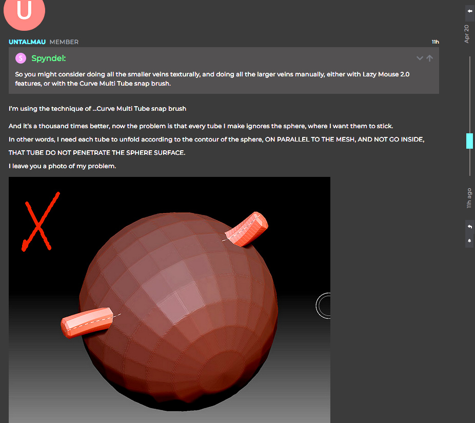

now , i was trying yesterday to use Curve Multi Tube snap brush, and works perfect but the tube go and penetrates the surface … and i need different… and
I need to attach the tube to the contour of the surface …
i mean NOT penetrate the surface.
and second using: Curve Multi Tube snap brush
I need the tube to start thick and finish thin.
like a vein or artery, attached to the skin.

The Curve Tube Snap brush will snap to the surface of the target mesh. This is fine if you are drawing tube by tube.
The Multi tube brush will not snap to surface–even if you enable snap in the the stroke > curve settings for some reason. I recommend the Multi-tube brush for use with the topology brush. The topology brush curves do snap to surface, and then the multitube brush can draw tubes along all those curves at once.
It is far easier to draw the tubes, then sculpt them into the desired shape after the fact. I recommend the Infat and Pinch brushes at a low intensity setting for this. A low Z intensity setting will let you softly brush them repeatedly for gradual changes, rather than an abrupt change.
If you sculpt the lines directly into the mesh with lazy mouse, then pressure sensitivity and a tablet will let you taper the stroke.

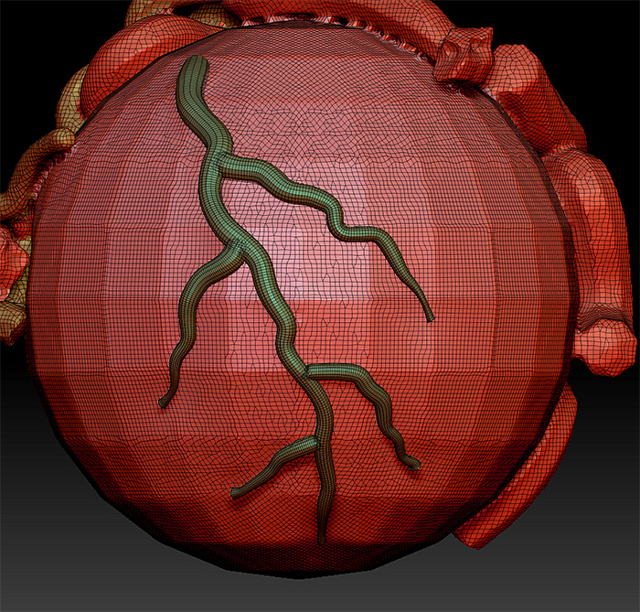

i use like you say …
  1. Topologi Brush
  2. Multi-tube brush and apply
  3. sculp
now, please ,
How can I select those tubes, so that:
when applying, brush inflate or pinch, does not affect the surface (mesh)
just the green tubes, to be inflated and pinch ?
please brother ?
zbrush 01
any comment please… how select only green tubes to apply inflate and not to mesh please ?

The ways you protect geometry from being affected by an operation in Zbrush are:
  1. Hide the geometry (much easier with Polygroups)
  2. Mask the geometry (also much easier with polygroups)
  3. Split the geometry into a separate subtool.
  4. In this situation, Brush > Auto Masking > Topological Masking and Mask by Polygroups may also be useful.
These are fundamental Zbrush concepts. Everything you try to do in the program will be more difficult and take much longer if you have not learned the basics. Be sure to read at least the Getting Started section of the Zbrush documentation, and check out the Pixologic Classroom as well.
