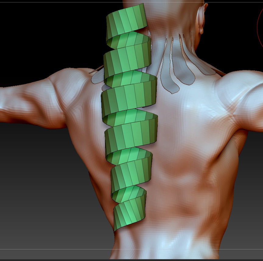

OK… Got it figured out.
  1. Load up a blank scene.
  2. Load up a Helix,
  3. Scroll down and you will see a hidden menu under Tools made visible called Initialize. You have all the options that Cath mentioned briefly.
  4. Investigate, play around until you get it the way you want it.
  5. Tools> Polygroups> Groups by Normals
  6. Ctrl + Shift to select the outer Normals.
    ** note: To check to see if the entire outer spiral is there go to Tools> Display Properties and click Double. Should be fine.
  7. Tools> Geometry> Modify Topology and click “Delete Hidden” button
  8. Save it out as tool and as an OBJ.
  9. Load up the scene you want to bring it into
  10. Tools> Subtools> Insert and your Helix should be there. Click it and it will insert it in UNDER the layer you have selected on top.
