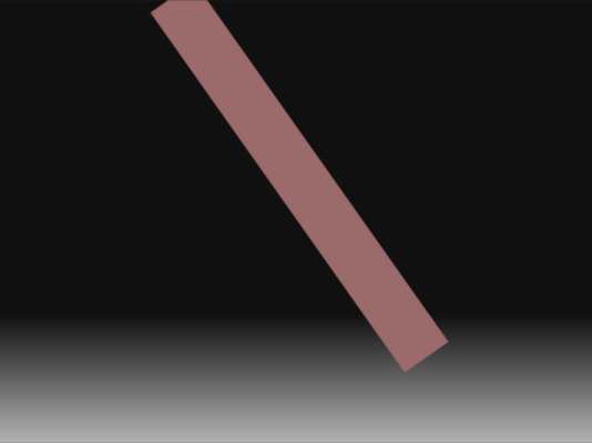

Tool>Initialize. You’ll find values for X and Y. These are percentages out of 100. By default, both are at 100 which gives you 100% x 100% – a square.

To create a plane3D of the same proportions as your canvas use the Tool>Initialize options as aurick suggests.
To scale the plane3D so that it fits the canvas:
  1. Draw the plane3D on the canvas. Don’t switch on Edit mode, or if it is on switch it off.
  2. Press Scale so that the Gyro appears.
  3. As spaceboy says, in theTransform menu, click the Info submenu. Three sliders will appear, labelled X Component etc.
  4. Enter half the shortest canvas dimension (height or width) into all three sliders if your plane3D is the same proportions as the canvas.
    OR
    Enter half canvas width in X Component, half the height in Y Component if the proportions are not the same.
