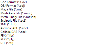

It depends on which file format the 3D scan is in. Below is an image of all the file formats that ZBrush can import. If your scan is in one of those formats, then just click “Tool > Import” to bring it into ZBrush.
2021-05-05 11_34_38-
If it is not in one of those formats, then Meshmixer might be able to convert it into one that ZBrush will accept.
