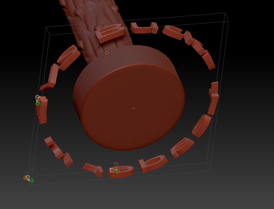

How do I tighten the radius of this 360 degree text?
Hi everyone. I’m new to Zbrush and trying to teach myself the program. I don’t understand how I can lessen than the whole radius of this wrap around text in the x axis. (So that it will fit on the object without making the text smaller)
What would be the best way to make this text fit the bottom cylinder without making the text smaller or bigger? I was thinking I could use Bend Arc and find one of the cones that would lessen the whole radius but none of the cones will do that. The radius cones will only pull stuff from one angle and things are deformed.
thanksBEND ARC
Bend Arc will do what you want. Assuming you started with a line of text, centre the Gizmo on the text. Move the text so it is tangent to the cylinder wall. Looking straight down onto the cylinder (Y axis by default), switch to Bend Arc, click on the green cone at the centre of the bounding box (where the Gizmo centre was) and drag to create a circle of 180 degrees (hold shift for increments). Yes it will be big. Then click the white cone and drag towards zero and probably even negative (i.e. past the centre so it points in teh opposite direction) to shrink the size of the circle until it matches the size of the cylinder. You can flip between Gizmo and Bend Arc to adjust position as you go. When with Bend Arc hit Accept.
To simple shrink the circle text you already have in the image, centre the Gizmo on the circular text, click on the green scale Y icon on the Gizmo, hold ALT and drag. This will scale in the directions other than Y, i.e. X&Z. In other words, it will do a radial scale.
