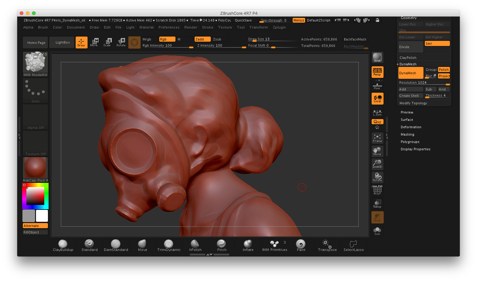

How do I keep perfect details before printing?

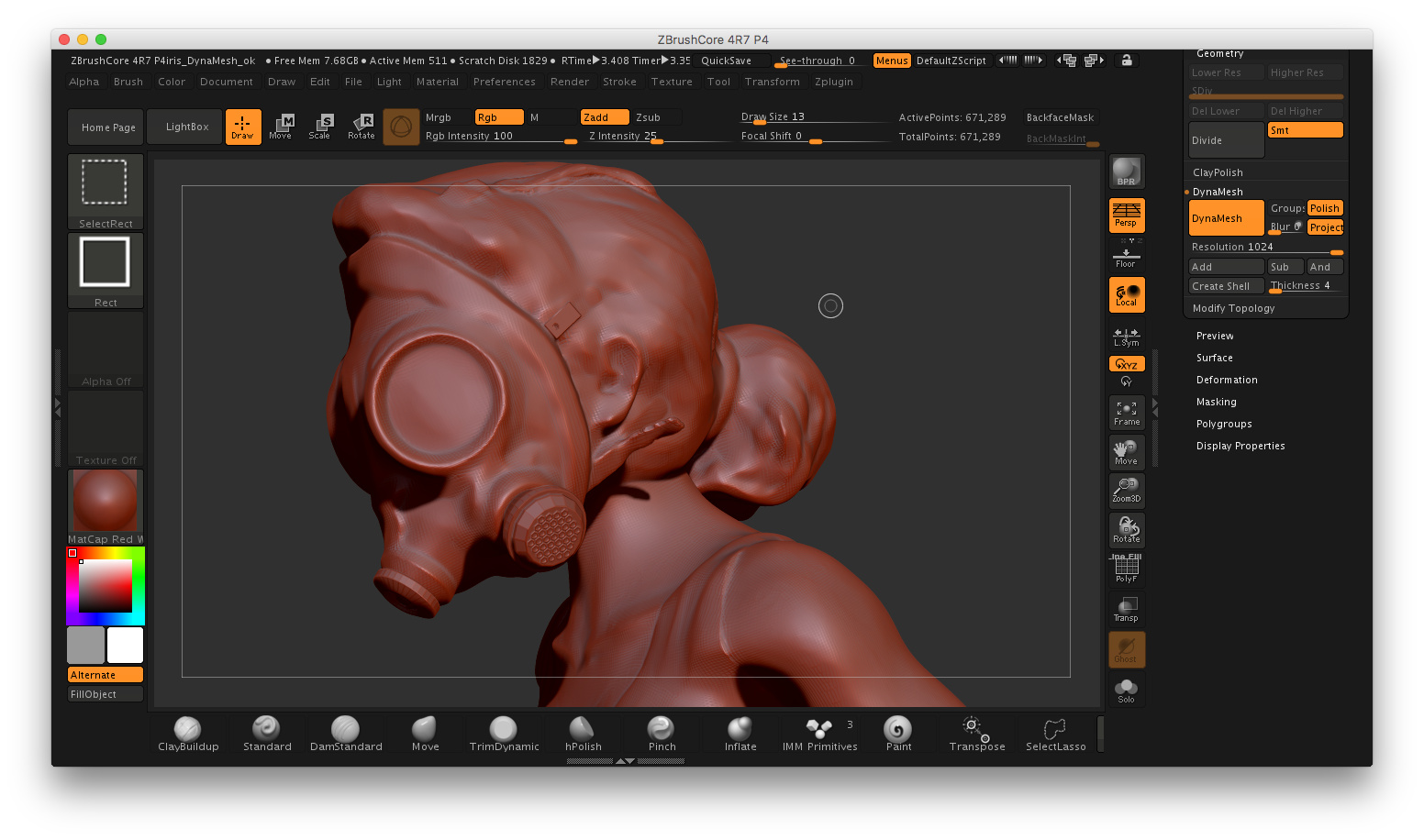

I finished a cool girl statue ,I want to 3d print her
So all objects are combined(MergeDown)。
It is one of the things that need to be printed,So I went on to execute another one(DynaMesh)
For the fineness, the Resolution value is set to 1024 max
But the details are still lost…
Would like to ask me how to do, will complete the perfect combination of objects, and then print.
thank you very much :)
Love the design, I was struggling with the same too over the past couple of days. Have you tried the Dynamesh master (http://www.zbrushcentral.com/showthread.php?177194-DynaMesh-Master!-unofficial-Information-Installation) plugin, that will give you the ability to keep the amount of polygons the same, thus keeping the resolution of the details much better and making it into a dynamesh. After that you can do a project all with both tools and than try decimation master (http://pixologic.com/zbrush/features/decimation/) do decimate it and get it to the STL file using the 3d Print hub. What printer are you going to use? SLA of FDM? I’m using the steps from Joseph Drust (http://www.zbrushcentral.com/showthread.php?199827-Thread-of-Madness-Joseph-Drust/page10&highlight=Print+breakdown) and that gives me the perfect mesh for printing, I’m printing on a Ultimaker 2 (FDM) and using Simplify3D for slicing.
Looks like a good program, but it is impossible to operate these zubushcore plug-in software. This can only work on the professional version.
You can increase the effective DynaMesh resolution by also enlarging the model beforehand - Use Tool>Deformation>Size on the merged model. Setting the slider to 100 a couple of times will probably be enough.
You might also try turning off the DynaMesh Polish option as that might be losing you some detail.

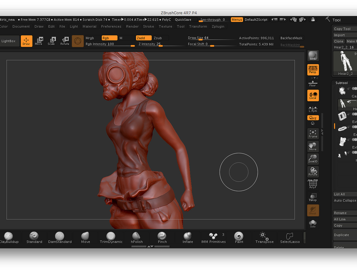

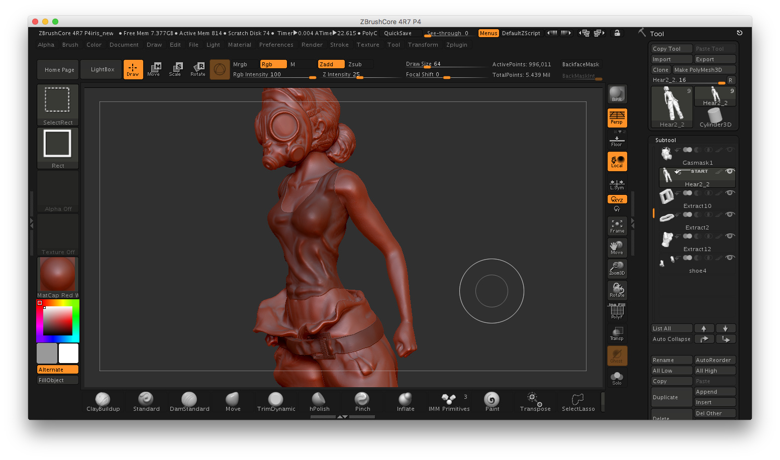

I try to increase the size of the core to 200 units, get the results as shown above (so still acceptable) will continue to try other values to achieve better results. Thanks for the two valuable suggestions! thank you all!

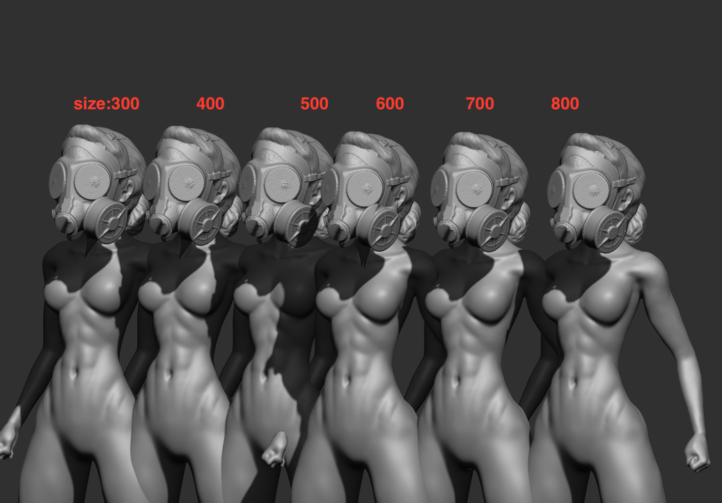

Try to adjust the size from 300 to 800, 800 part of the increase in the head of the subdivision, which seems to continue to increase the size, and will not make the situation better, but did improve the original surface condition.
