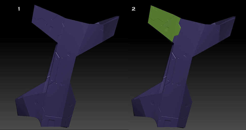

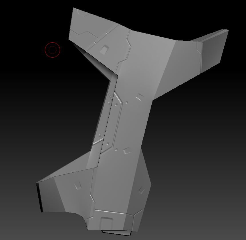

Here is the subtools I want to divide up in order to print it easier.
panel split demo
It consists of a single high poly mesh and I want to slice it up into parts along the sculpted panel lines to hide the seams of the different parts as much as possible. Usually I would use the slice curve to separate it into different poly groups.

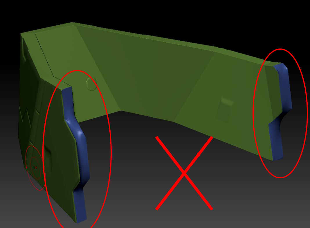

Run a split by group function and run a close hole command to close the seams. But due to the corners and complexity of the cut the topology that is generated to close the holes is a bit wonk!
Is there a way to separate those parts and get clean straight topology between them to make both printing and assembly easier?

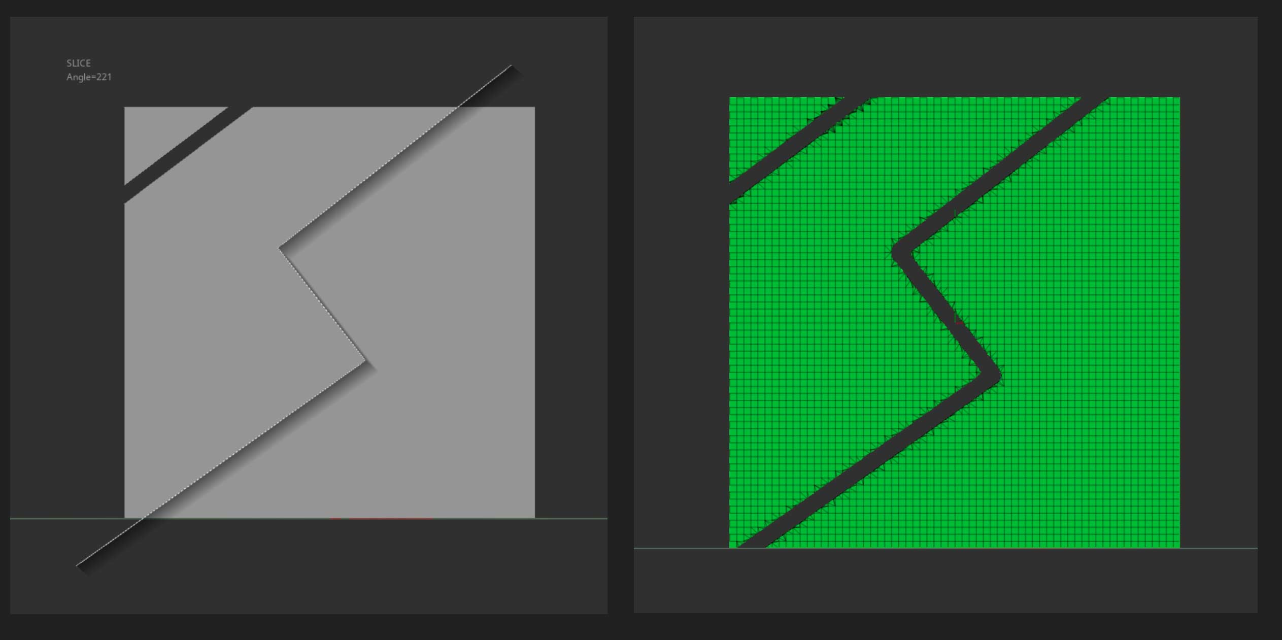

  1. Quick and Dirty:
Use the Knife Curve brush, and activate Brush> Clip Brush Modifiers> BRadius.
Now when you cut along the knife curve stroke it will cut out a “slice” of the mesh along that stroke with the thickness based on the DrawSize.
However, if you press and hold ALT after starting the stroke, it will instead cut the mesh into two or more separate volumes separated by a thickness determined by the Drawsize. Please see the following image:
Please keep in mind that the Knife Brushes are very sensitive to issues with the geometry. If your mesh has any problems reported with Tool> Geometry> Mesh Integrity Check Mesh you will need to fix these or you may experience stability issues with the brush.
Likewise , try to avoid cutting through edges of the model that have already been cut by the tool, as it produces suboptimal topology along those edges that could be problematic for additional cuts. It may periodically be necessary to resurface the mesh to clean it and return it to quads to make further cuts in an area.
