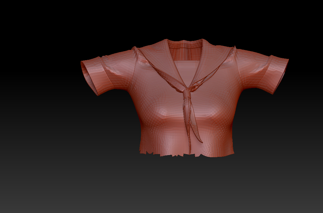

Hello,
I have this shirt which was too long, so I deleted the geometry with crtl+shift but it looks really messy at the bottom due to bad topology. How do I make this straight?
Thanks
Hello,
Thanks
I would recommend undoing that and using the transpose tool to trim it instead of deleting the geometry.
Unless you press the button delete hidden the geometry is only hidden. Once you really delete the hidden geometry then you can use dina mesh to smooth it, or you could trim it too.
