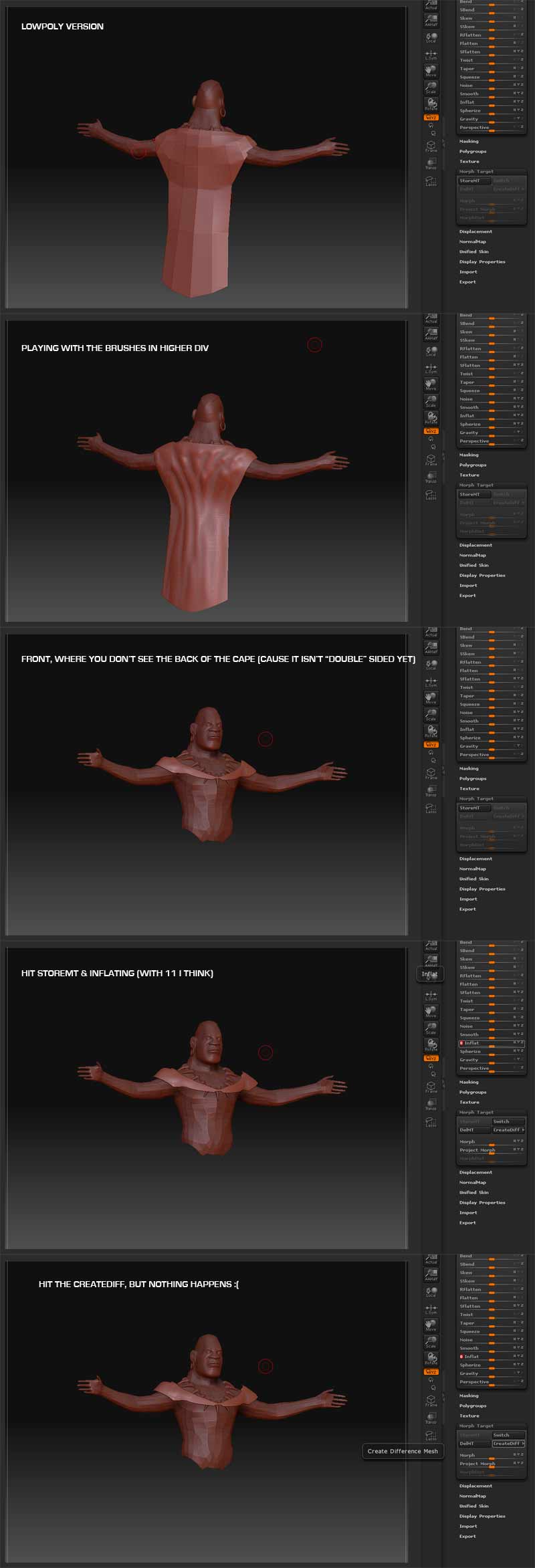

thanks for your help, I tried it out but I think I’m doing something wrong.
When I hit the button “CreateDiff” nothing is happening :frowning:
Check the image i’ve add in this post, to see the steps I’ve done
try it with a simple plane. The idea is to have a poly object, store it’s current status as morph source, then do something with that object and hit create diff. The result is a new mesh between the source and the last modification.

Aha :warning: I’ve found it out, didn’t knew it was a new mesh that was created and had to append it to the “base” mesh.
Thanks for your help :+1:
When you create the difference mesh, it appears as a new object in the Tool paletted. What’s on your model, though, is still the original cape. What you need to do is append the difference mesh to your model (and probably delete the current cape).
