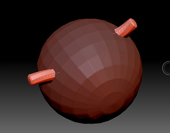

I’m using the technique of …Curve Multi Tube snap brush
And it’s a thousand times better, now the problem is that every tube I make ignores the sphere, where I want them to stick.
In other words, I need each tube to unfold according to the contour of the sphere, ON PARALLEL TO THE MESH, AND NOT GO INSIDE, THAT TUBE DO NOT PENETRATE THE SPHERE SURFACE.
I leave you a photo of my problem.
borrame bar b
I need to attach the tube to the contour of the surface …
i mean NOT penetrate the surface.
