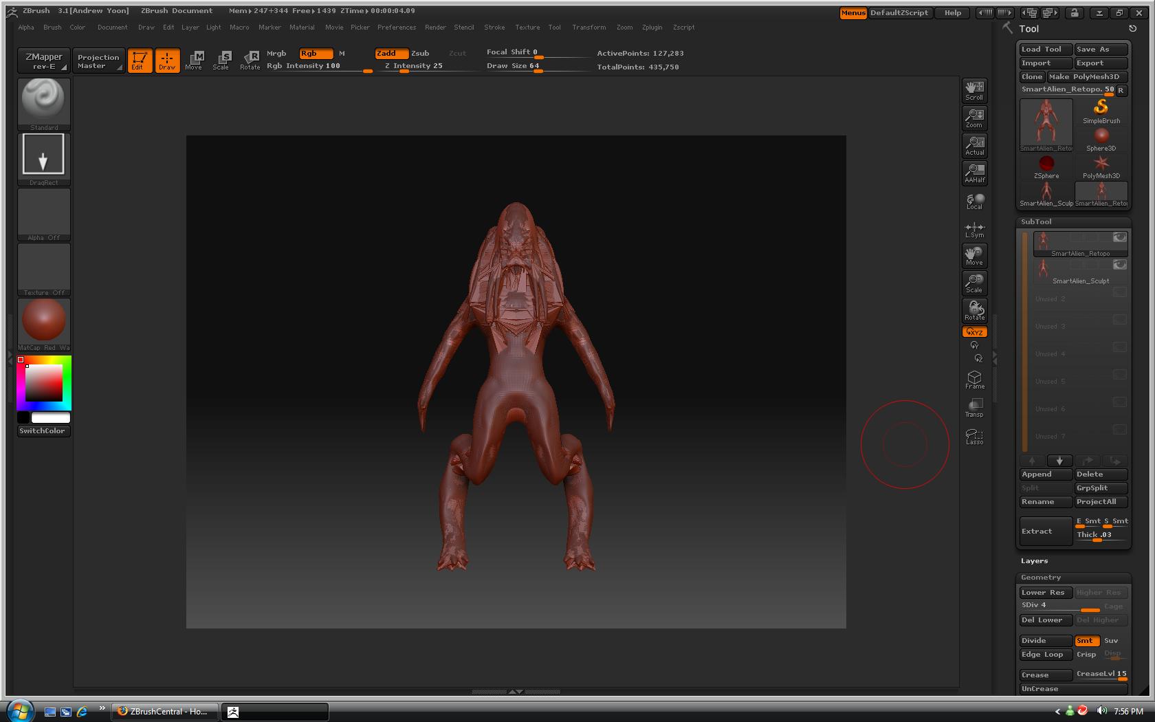

when I put the polygons either higher or lower than the detailed version, I still get get:
](javascript:zb_insimg(‘106103’,‘Alien.jpg’,1,0))any ideas???
have you looked at your normals and what direction they are pointing?
crap!! That’s probably it!! And just a few hours ago I deleted my low poly version because I had given up hope on restoring it lol…Ah well, It’s not that bad
OK, well, I’m trying again (I got the normals sorted out), but there are still a couple small areas (oddly enough, in the areas of topology I DIDN’T change) that are going all over the place. Is there a simple way to retopologize a higher resolution model while NOT viewing the highest resolution?

no, what I’m trying to do right now is retopologize my lowest subdivision level, while preserving all my upper detail, but using Project All sends a bunch of spots all over the place, and my normals ARE WORKING.
