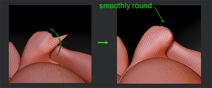

how can I smoothly round the tips
hi …
on picture i got it to round smoothly the sharp tips
but take 20 minutes doing
question is ther any other way to do this mor fast and profesional ?
will apreciate so much any ideaor comment.
here is a picture to show what i need…
again thanks a lot any help
Go to Brush/ Smooth Brush Modifiers and set Min Connected to 1… Then use your smooth brush and perhaps a mask and those little artefacts will flatten out much easier.
I’m assuming that you are just using your smooth brush and that there is a single point that is at the tip, which creates a problem… Otherwise not sure why it would take so long with a a dynamesh.
