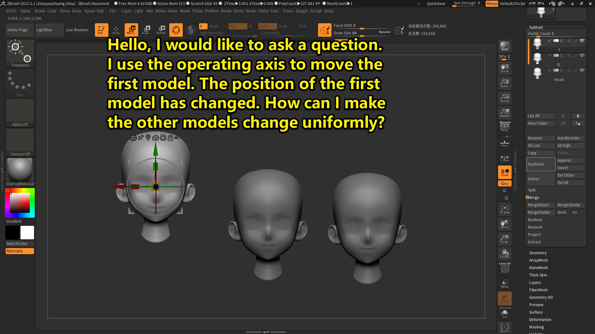

How can I make the other models change uniformly?
Hello, I would like to ask a question. I use the operating axis to move the first model. The position of the first model has changed. How can I make the other models change uniformly?
You need to store the original position of the subtool first, then you can apply the change to the other subtools like this:
[VarDef,shiftX,0]
[VarDef,shiftY,0]
[VarDef,shiftZ,0]
//before moving a subtool, store position:
[IButton,Store_Pos,"Store the position of the selected SubTool",
	[VarSet,shiftX,[IGet,Tool:Geometry:X Position]]
	[VarSet,shiftY,[IGet,Tool:Geometry:Y Position]]
	[VarSet,shiftZ,[IGet,Tool:Geometry:Z Position]]
//after moving a subtool, shift the others:
[IButton,Move_All,"Move All other SubTools",
	[VarSet,activeSubTool,[SubToolGetActiveIndex]]
	[VarSet,shiftX,[IGet,Tool:Geometry:X Position]-shiftX]
	[VarSet,shiftY,[IGet,Tool:Geometry:Y Position]-shiftY]
	[VarSet,shiftZ,[IGet,Tool:Geometry:Z Position]-shiftZ]
	[SubToolSelect,0]
	[Loop,[SubToolGetCount],
		[If,[Val,n] != #activeSubTool,
			[ISet,Tool:Geometry:X Position,[IGet,Tool:Geometry:X Position]+shiftX]
			[ISet,Tool:Geometry:Y Position,[IGet,Tool:Geometry:Y Position]+shiftY]
			[ISet,Tool:Geometry:Z Position,[IGet,Tool:Geometry:Z Position]+shiftZ]
		[IPress,Tool:SubTool:Select Down]
	,n]
	[SubToolSelect,activeSubTool]
Note that you need to use the [IPress,Tool:SubTool:Select Down] to move through the subtools in the loop as using [SubToolSelect] for this operation won’t give you the results you expect!
Also, a reminder of the Tool>Deformation>Repeat To Other button which can be used to repeat operations to the other subtools.
-Marcus
