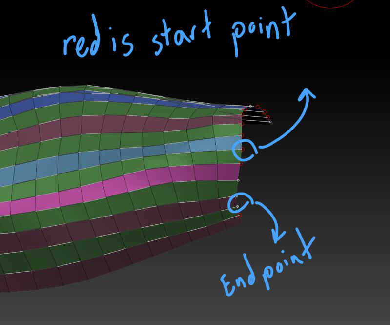

how can i change start point to end point .
I want all points to be endpoints.
Thank you for your guidance.

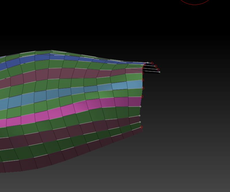

Hi @miner ,

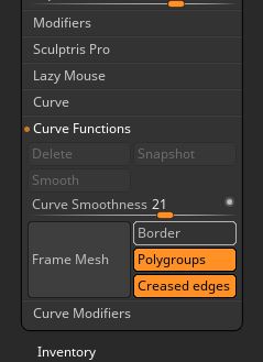

You appear to have a piece of 2D geometry with cleanly defined strips of polygroups. Try deleting the existing curves and going to Stroke> Curve > Curve Functions. Use the “Frame mesh” function with only the “Polygroups” option active. The active crease option may be complicating the results.
This should draw out all the curves at the same time in the same way. It is not always understood that you can actually create live curves via any available method, then switch to the desired Curve brush to apply the stroke.
If this does not work, it may indicate an issue with the geometry , or something about the scenario that is not apparent in your screenshot. Geometry> Modify Topology> Align Edges may be of use.
As long as all the curves are the same, you can generally invert their functioning by reversing the Lock/Bend Start and End buttons in Stroke> Curve.
