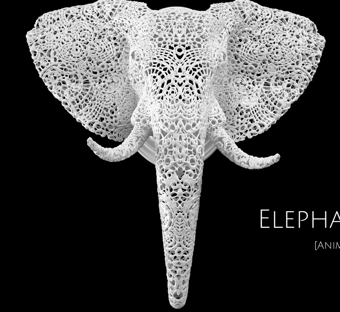

Hi, apologies for any errors in my knowledge as im still learning zbrush. Im trying to achieve an effect whereby i have made a vase, and i want to add a lace type pattern to it. then invert it and remove the spaces away, so that pattern is masked around the vase and has holes through it, does that make sense?
i am trying to achieve this effect, on a vase model. http://lpjacques.com/creation/elephant-animal-lace/

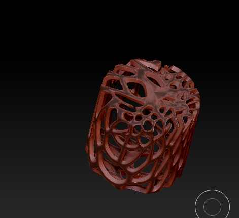

Thanks a lot for all the instructions on this particular part, I’ve been searching for this a long time. The UV master plugin is really great for getting a nice result of the UV. Using masking by alpha and extraction I managed to get this Voronoi like structure on a cylinder (the mask is still on it) Schermafbeelding 2015-05-29 om 14.27.15.png
I had to extract on a really high smt level, than it comes out beautifully. Thanks a lot
